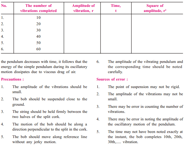

You should do an experiment where you see how much energy , Here is how its mentioned in our textbook
The total energy of the bob of a simple pendulum executing simple harmonic motion, :
OR ANOTHER WAY HERE :

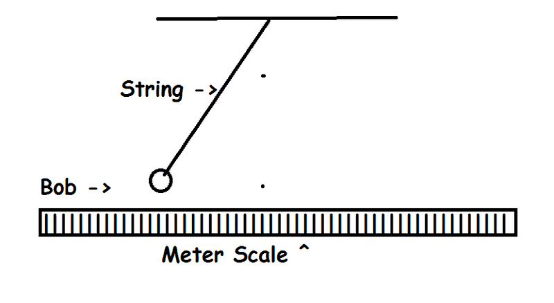

Setup :
You also need a stopwatch
Procedure :

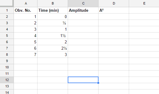

Set the Pendulum to oscillate with suitable amplitude, and simultaneously start the stopwatch (make sure to get one)
Note down the Amplitude after every one minute
Observation Table :
Why A2 -> Because if you plot a Graph of A2 vs T, You'll get it
Theory : The Energy of a Particle performing SHM is given as :
Which means E is Directly proportional to A square
