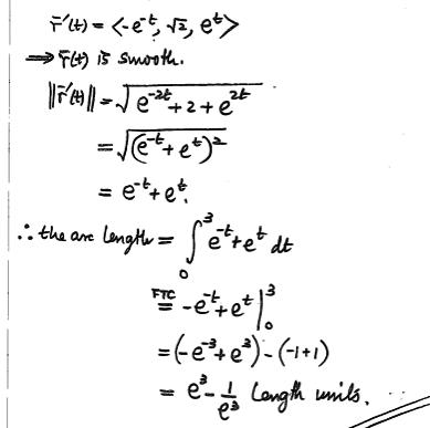

I don't understand why my instructor simplified this problem like he did. I get how we took out the square for the (e^t + e^-t)^2, but what happened to the 2 under the square root.
Pic of solution is attached
Do you know what cosh(t) is?
Don't delete the template, and show work please.
I attached a screenshot of the solution. I just need clarification on the simplification done from line 3-4. And I know about hyperbolic trig, but I doubt that that was used there.
Under the radical, the expression (e-t)2 + 2 + (et)2 looks suspiciously like (a2 + 2ab + b2).
If fact, if you let a = e-t and b = et, you will find the the expression under the radical is the perfect square, namely (a + b)2.
Note: No cosh needed.

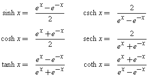

I forgot most of the hyperbolic trig stuff, but this doesn't look like any of the hyperbolic trig functions. And my attempt at the solution is exactly the same as the attached solutions, except I don't know how the stuff under the square root was simplified.
You can get the simplification from cosh(t) like I did, or you can use SteamKings result which is probably easier.

oh. ok that makes sense. Thanks. How do you solve those kinds of problems again? Going from (a^2 + 2ab + b^2) to (a + b)^2. How do you exactly do that. This looks familiar, but I haven't done it in forever. I know if you have something like z^2 - 2z you can divide the second term and square it, giving you (z-1)^2. Does my question make sense? I want to make sure I know how to simplify more like those in the future. Can you show me a similar (simpler) example and how to simplify it.

Well, sometimes you do it by trial and error. The key in this problem was that you had et and 1/et, so that when you multiply these two terms together, you'll get a 1. One of the algebra facts you should remember is how to expand (a + b)2 into a2 + 2ab + b2.

If you want to look at the problem as I did, $$\sqrt{{e^{2t}+2+e^{-2t}}}$$ $$\sqrt{{(e^{t}+e^{-t}})^2}$$ $$2\sqrt{(\frac{e^{t}+e^{-t}}{2})^2}$$ $$2\sqrt{cosh^{2}(t)}$$ Assuming t is real = $$2cosh(t)$$ Which is just what you were trying to show. All I did was add an extra step you don't actually need, unless you wanted to evaluate the integral as ##2\int{cosh(t)dt} = 2sinh(t)+C## which is a bit easier to do quickly.

The OP really continue from the last expression above, without having to convert to hyperbolic cosines. As already mentioned, the quantity inside the radical is a perfect square, so simplifying it reduces to ##e^t + e^{-t}##, which makes for a simple integration in finding the arc length.
