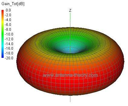

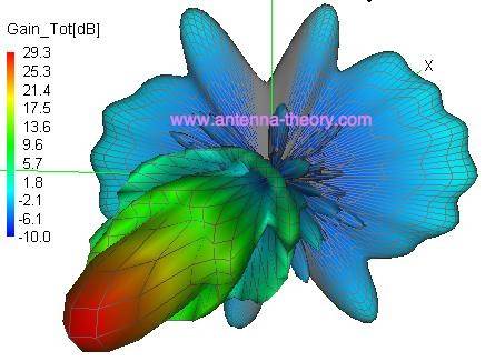

Right, but in reality it depends greatly on the antenna design. An omnidirectional antenna goes in all directions, but others not so much. Here's a power pattern (showing its "strength" in all directions) for a more directional transmitter:
Likes Justin N

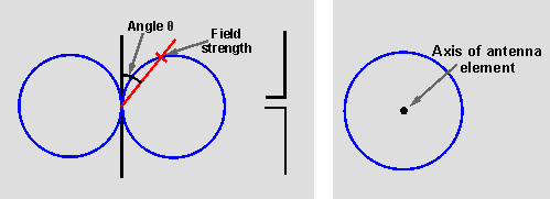

Justin N said:
So I'm assuming the fields radiate into all three dimensions with equal strength?
for a single charge in free space, yes
for charges in an antenna, no. No antenna radiates equally in all directions
the closest you can get is with a dipole antenna which will produce a doughnut pattern
there will be near zero radiation off the ends of the dipole
side on and above ...
Dave
Likes Justin N

Justin N said:
Thanks for all the help Davenn. The visual really helps put it together.
Just to be clear, are you aware that those illustrations represent the intensity of the EM wave generated by the antenna and not the shape of the wave?
Likes Justin N and davidge
Negative, I did not know that. You've thrown me back into the abyss Drakkith. Haha I'm going to have to think about this one again
just to be even more clearer... you were asking about an antenna/charge radiating evenly in ALL directions
my illustrations are showing you that for, eg., a dipole antenna they don't ... which is what I stated
you can clearly see that the intensity of the signal varies depending on where it is measured relative to the antenna
Strongest directly perpendicular to the sides and near zero off the ends of the dipole
The illustrations are showing you intensity Vs direction from the antenna
does that make sense to you ?
Dave
Likes Justin N
Dave
I believe so. I understand the strength of intensity shown by the color. I need to do some research on a dipole antenna though. Thanks for the info.
