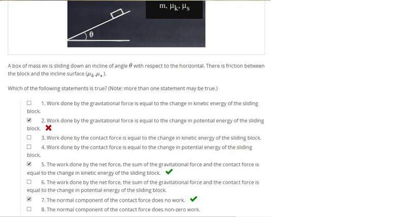

It's in the picture attached...
None...
I picked options 2, 5 and 7 to be true but 2 turned out to be false. I can't figure out why it's wrong and an explanation would be appreciated. I mean it makes sense to me because work done by gravity is F*s which is (m*g)*h which is the same as the formula for gravitational potential energy, U = mgh

i assume that you were using W=mgh and U=mgh? this is only correct when it is vertical, but since there is an angle θ, you need to use that other Work equation (W=Fdcos θ) which means that potential energy is not the same as Work. again, that would only be true if it were vertical such as a raindrop.
Pay careful attention to the wording of option 2. When the block slides down, is the work done by gravity positive or negative? Is the change in potential energy positive or negative?

Oh. Does this mean that Eagle's answer was wrong and that the reason answer 2 is false is not because the formula of work is not mgh as Eagle argued but because change in potential energy is equal to - (work done by gravity) and not equal to work done by gravity itself?
Yes.
