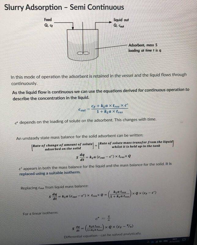

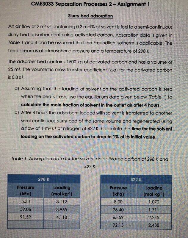

Summary:: I have an assignment on slurry bed adsorption and would like to know how to calculate residence time as it is not specified. I was also wondering if anyone had any suggestions for another isotherm to try and fit the data to (other than freundlich). Thanks
##\frac {dq} {dt} = \frac {k_la .t_{res}} {1+k_la.t_{res}}.\frac QS.[c_F-c^*] ##
where:
##t_{res} =## residence time ##(s)##
## k_la =## volumetric mass transfer coefficient ##(s^{-1})##
##Q= ##Volumetric flowrate
##S= ##adsorbent mass
##c_F=## feed concentration
##c^*= ##Concentration in solution in equilibrium with the loading on the adsorbent (suitable isotherm used)
I know that I need to use the equation specified above and solve numerically to get the loading after 4 hours. However, I am not sure how to get the residence time, as this has been specified in previous examples that I have done. I was also wondering if anyone had any suggestions for another isotherm to try and fit the data to (other than freundlich). Thanks

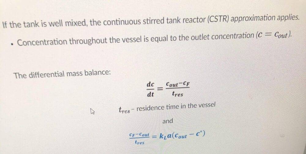

Here is the derivation, where ##c_f## is concentration of adsorbate in feed and ##c_{out}## is the concentration of adsorbent in outlet. I understand it but we are usually given residence time, however it is not given in this question.
The parameter a is the total surface area of solid particles in the slurry divided by the total volume of slurry. So the total molar flow rate of solute to the solid surfaces is ##kaV(c_{out}-c^*)##, and this must equal to the volumetric flow rate Q of solvent through the unit times the change in concentration of solvent between inlet and outlet of the unit: $$Q(c_{out}-c_{F})=-kaV(c_{out}-c^*)$$What does that tell you about the residence time?
I'm not sure sorry. How would you get the total volume of slurry (V) in this example? as there is a continuous flow of liquid
The problem statement states "the absorber bed ..., has a volume of 25 m^3." The value of V is 25 ^3, and the residence time is 12.5 seconds.

No way. In a CSTR, the mean residence time is equal to the reactor volume divided by the volume rate of flow.

How would you know the volume fraction of the solvent, would it be 0.3%*2m^3s^-1?
Where did the "2" come from? Volume fraction in a gas is a synonym for mole fraction.
Please could you point me in the direction of an equation used for desorption (part b), I have no idea what to use. Thanks
You use the same equation, except that now, C* exceeds Cout
