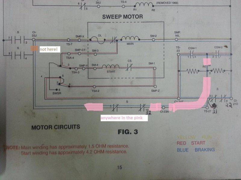

jim hardy said:
somewhere in the pink line
in place of that wire from C1-23N to TS-27
or C1-23N to whichever terminal that is on the S relay, 10 or 32

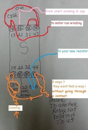

Schematic shows a wire between relay S terminals 2, 4 and 5
that could be a convenient place if you can see clearly how they accomplished their wiring,
just be careful , you don't want it on the wrong side of terminal 4 !
if there's a single wire on 5 find its other end, hopefully it's a short jumper to 4&2. ( with a single wire from one of those to C1-22J , that's how i woulda done it. )
even between junction of capacitors and centertap of resistor would be okay
schematics don't look a lot like the physical machine, do they ... Got a cellphone picture of it you could upload ?
old jim

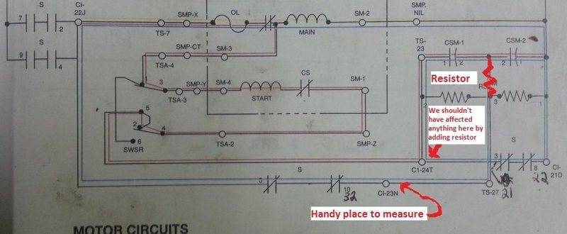

OK Jim put 8 ohm resistor in place between cap and resistor. Braking unchanged it's OK
Voltage at C1 24 and return unchanged voltage drop off is still quick when running

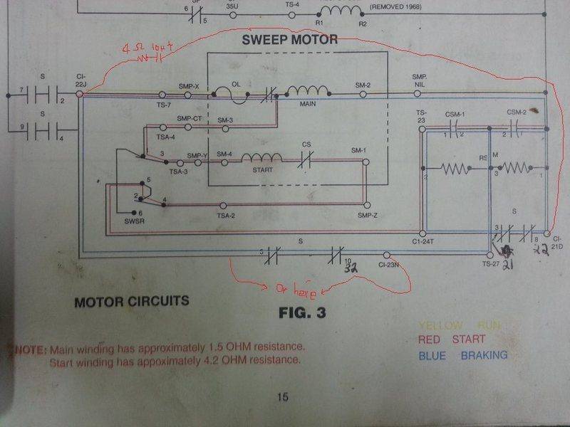

Did i draw it in the right place ?Braking unchanged it's OK
That bodes very well , and i must admit to mild surprise bur tremendous relief
Okay, take a look we'd expect no change there
During braking, motor's main winding current flows along blue line into new resistor then splits. half going through each capacitor to 115 return.
The half that turns right into CSM2 has a straight shot out other side to 115 return
the half that turns left into CSM1 meanders back through C1-24T then contacts 3-8 of S relay to 115 return.
If i understand the circuit,
Voltage at C1-23N should behave like this
At motor start it will jump up to the 22 VAC/(41DC?) you measured in post #70
(question mark on DC reading is because i think it should be random how much DC you see there, if it's always 41DC i don't understand why (but that's not unusual ) )
then it will drop to zero as soon as motor reaches speed causing CS to open
when STOP signal de-energizes relay S
allowing its NC contacts to close
voltage will return to C1-23N , and the amount will be whatever the motor makes as an induction generator. That voltage will fade as energy id drained from the motor's inertia.
The resistor should affect rate of energy drain from motor, but how much ? I don't know(the 3 words men fear most).
That resistor HAD to lower the instantaneous current flow into the capacitors, making life easier for your NC contacts.
Since we don't have a 'scope with transient current capture, and my coil didn't tell us anything, we're flying kinda bindIf you can get a reading at C1-23N during a motor braking cycle, we'll divide that by (8 - j 2.65) and figure the amps during braking. (8 is the new resistor you inserted in the circuit...? )
I'm dying of curiosity how much current flows and for how long

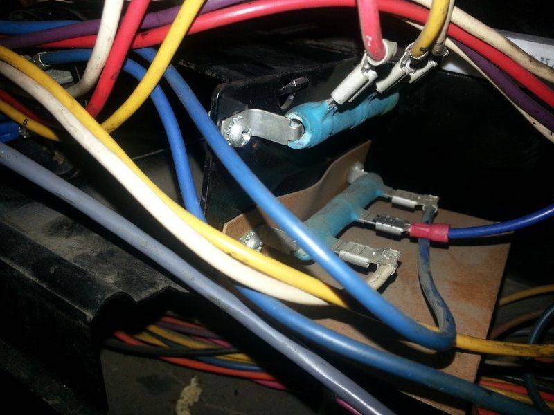

Got a picture of your resistor installed ?

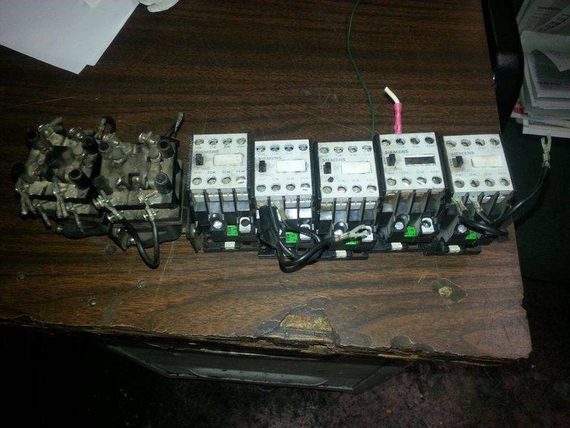

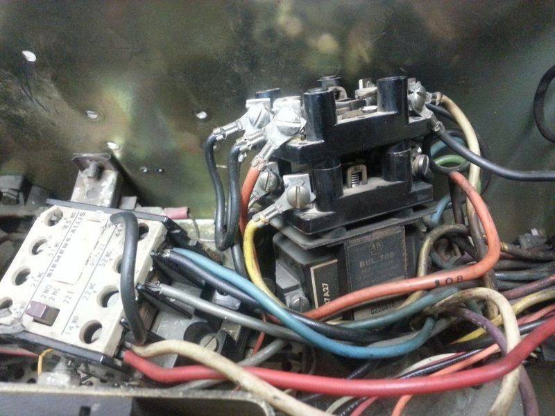

I did see the picture of the two relays - one is a siemens-allis ?
I too prefer open relays, my plant used Westinghouse BF's. Trouble with them is during construction little pieces of wire insulation and pieces of Ty-Wrap that the electricians cut off fall into the open contacts and keep them from closing...

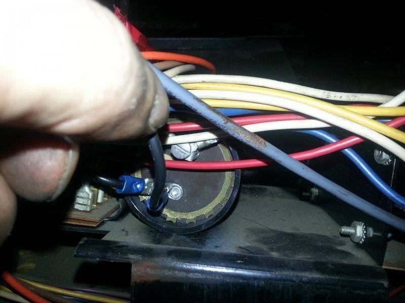

One pic is resistor and the other pic is wire to cap. Got to stuff everything into duct.

I've been digging for how to estimate subtransient reactance of induction motors.
Sparse...
Here's an article that mentions it, see page 12 of 14
http://people.physics.anu.edu.au/~bdb112/engn3225/Chapter_04_Motors_revA.pdf
i'm thinking six to ten X FLA should be the initial braking current spike into those capacitors ..
6 amp motor, 36 to 60 amp spikes, 10 amp relay contacts rated for 3X that much make current = 30 amps,
do you think that might erode them ? I doubt it's enough to weld them...
The over heating - I'm at a loss there.
old jim

  • #119
hmm top resistor is table and bottom one sweep ?
  • #120
Yes bottom is sweep

guys some speculation here, followed by a question...
i've been obsessed by the thought the contacts are being eroded by current from the motor
and have tried to operate the braking sequence millisecond by millisecond in my head..
loooking for a relay race between the NO contacts opening and the NC contacts closing
it is necessary for the NO's in upper left to clear before the NC's below close , else we have a near dead short across the supply as shown in post #43
what if... entertain this thought experiment for a moment ... HO12 answered this long ago when he said
H012 said:
The only fact I know is that the NC arcing occurs when they open, only because I can see it.
when what opens ? The NC's or the NO's ? We established by test that there's no current through the NC's when they open by measuring voltage at junction of the two capacitors if i understood. It drops to zero after motor starts and remains so until braking.
So if the arcing is observed at braking time when the NO's in upper left open, that's not surprising because they are interrupting motor current and it's an induction motor.
Anybody who's arc-welded knows an arc can persist surprisingly long
so in the thought experiment, think millisecond by millisecont from the instant the S relay plunger starts to travel to de-enegrgized position
1. NO contact opens a ten-thousandth of an inch establishing an arc
2. NO contact continues its travel, arc gets longer
3. NC contact makes initial contact , connecting motor to capacitors which are nearly a dead short
4. Current through NC contact consists of current from motor plus any leftovers from the arc - at this instant NC does not yet have full contact pressure so some melting might occur
5. NC that's NO contact continues widening its airgap, quenching the arc (sorry for the mistake :mad::mad:):frown:
6. NC contact establishes full contact pressure and commences to cool whatever metal was melted in 4.
Now here's the speculation
Which comes first ? 4 or 5 ? If NC makes before NO has extinguished its arc, we have a short across supply through a not quite extinguished arc and a not well seated NC contact that's still bouncing... see post #87
Is that scenario plausible?
so the relay race i was looking for isn't contact vs contact mechanical travel overlap but contact travel vs arc quenching time overlap.
How does energy deposition between two arcs in series divide?
Is this plausible, guys?
If so, a snubber across motor as in post #89 might help NC NO quench the arc before NC makes.('nother durn mistake :mad:)
That old saying, before you figure out what it is you'll figure out a lot of things it ain't.
H012 said:
I am positive the reason the SSR fail so soon on these machine is the repetitive cycling of the machines when we are busy average is about 15 seconds and the lack of adequate heat sinking on the MOSFETs is the problem.
If the SSR is SCR based and can't turn off the NO contact until a current zero crossing happens,
then there's an interval where it connects 1000 uf right across the line which could be a bodacious surge.
Looking for holes in that line of thinking
and any thoughts on how to test for it.
old jim
  • #124
H012 said:
I'm electrical engineer. I can understand more how contact bounce can occur. Or just not able to be firmly mated to the other contact.
okay i apologize if i seemed to be talking down, that was not my intent
i think in simple steps and it's the only way i know to communicatedo you guys have an oscilloscope?
If you get a chance , see how much current we get on coastdown (volts at resistor or capacitor centertap?)
and a sanity check on my previous post ? we crossed in the mail.
old jim

Here is a pic. of a SS relay (bad)
  • #126
oops step 5 above should say "NO contact continues widening.." instead of NC.. believe me it's frustrating to be so awkward...
will fix now
then look at ss relay picture thanks !

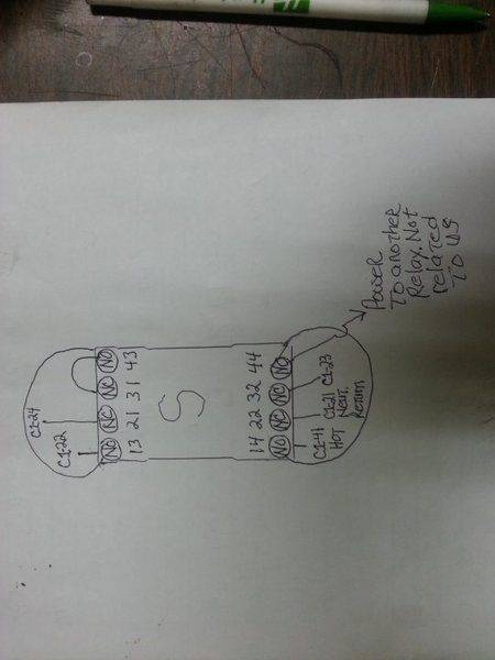

Jim I found this doesn't match schematic.Iook at pic. I tried to upload pic site won't let me Do you have Gmail?
  • #128
I got it to upload. Jim the black and blue wire are both coming from same hot at all times terminal strip in wire duct? Am I dumb!

gotcha. Can you tell any difference in arcing ?
not at all, just learning the details of your machine.
Machieavelli says a good prince knows not just every hill of his princedom , he knows every rock and every shrub on every hill of it. See my avatar...

I lost track of something here. If the removed Black wire refers to the sketch showing Black and Blue duplicate feed to the S and T relays, that shouldn't make any difference if the schematic matches the real world.
HEY GUYS, THAT REDUCED THE ARC TEMPERATURE BY 1000 TO 2000 DEGREES C. On the right track!
