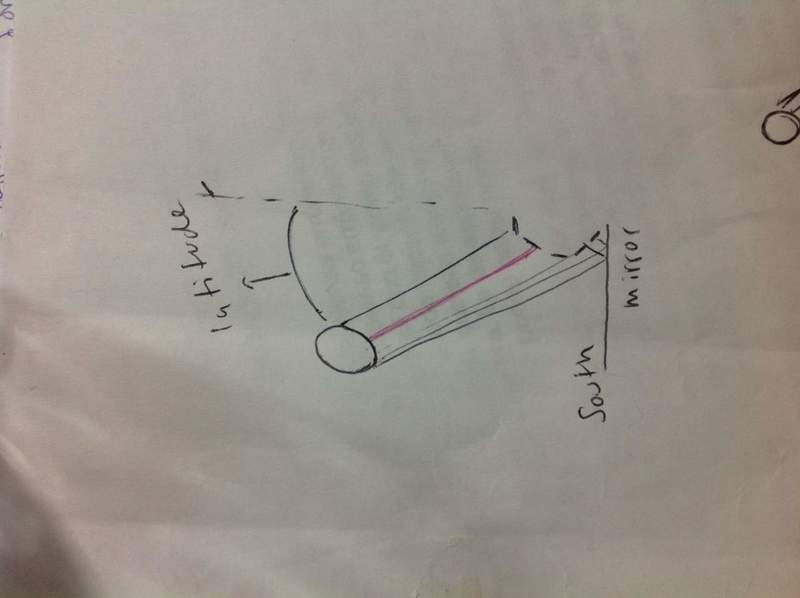

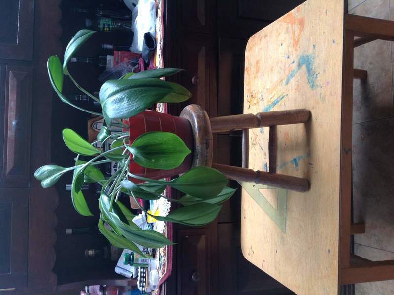

I am doing this project with solar panels. I thought, watching as well several youtube videos, that I could improve the panels with mirrors, and looking at some plants, I realized that some of their leaves bended towards the wall and the floor. The wall was white and that made me realize that they were receiving the light that bounced off the wall. I did some plant measurements and found out that the radius from the center of the plant to the tip of the leaves decreased with height, and that the angles of the leaves increased with height, so I came out with an arrangement sort of this way :
(what I was saying about the radius and the angle depending on height, I'm seeing height as increased if it goes down.)
(attached files)
The ones that are at the bottom, although they don't have the incident angle of the sun, they have partial reflected rays from the mirror and I thought they would be good as well because they could receive the scattered light for the clouds, so my model would work good in partially cloud days. However, I know that my plant measurements are not going to reveal me the most efficient way for me to settle these solar cells, and there comes the tricky part. I know that the way the rays enter depends on several factors, latitude ( my model would work best in higher latitudes since the reflected rays would have more angle), the tilt of the Earth's axis, although I am only focusing for now with the latitude. They say that you should face your panels south ( if you are in northern hemisphere that is), and tilt them depending on the latitude. I need to know how to arrange my panels, so that they have just the right angle and just the right radius, for them to receive the maximum amount of power.
In order to do such calculations, I know that the pink ray has higher energy because it travels less distance, and so the power would depend on how far the rays are. I know that the angle the ray has would be given by the latitude. I would need to calculate the area that the sun rays hit the earth, with that and the power given by the reflected rays, looking at their behavior, I guess I could then maximize the power received in the arrangement of the solar panels by putting them at certain angles, and at certain distances, but I'm not sure how to get there.

The plant leaf has better ability to use sunlight than standard solar cells, so diffuse light which is ineffective for solar cells is still quite valuable for plants.
Your desire to make your solar panels more efficient is good, so it is well worth while to set the cells on the right tilt to maximize their sunlight capture. Because sunlight is a pretty diffuse resource, mirrors and similar structures are marginal economically, they cost a lot to add for the added watts they contribute. Tracking and focusing mechanisms are even more iffy economically. In short, simple is best, just maximize the cell area getting direct sunlight between 9am and 3pm for the most return on your investment.

Thanks you all! I did some measurements with the mirrors, and no, they don't add efficiency. So far, I've seen tracking devices are the best, but a way for them to not using energy is necessary so that they can be implemented. What do you mean by polarity ? (1ledzepplin1) I've seen some that work using just some water bottles like the sun saluter from a Princeton girl, you should check that one, once again thanks !
