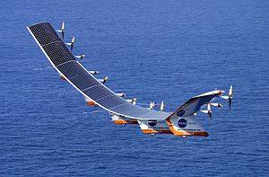

Didn't NASA / Burt Rutan do some stuff on solar-powered airplanes? They were really meant more for near-stationary / local satellite applications though, and weren't at all fast.
http://www.pvresources.com/en/helios.php [Broken]
EDIT: And not really meant to be crewed, either
Airplanes have a lot more surface area than helicopters. Apachee, try to think about where you would even put solar panels on a helicopter: by their very nature, they don't have a lot of horizontal surfaces except for the rotor.
