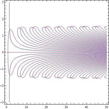

It's more than that right? I think there are an infinite number of solutions but don't know how to prove that. Here's some along the real axis (where the two curvers cross) and they repeat by 2pi along the imaginary axis I believe.
Anyone interested in proving how many there are?
