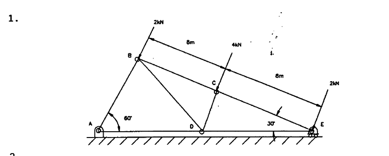

Can sombody help me out with this truss, i want to know firstly, i know i am to solve the forces in the x and y direction if possible, however, my question is, would the 2KN, 4KN and 2KN forces be forces in the y direction because they are not along the y-axis but diagonal.
Thanks

From the diagram, it appears these three forces are acting perpendicular to chord BCE which is at an angle of 30 deg. to the horizontal. The truss as a whole is a 30-60-90 triangle, but the diagram is badly drafted so that the forces appear somewhat skewed with respect to the other members of the truss.
