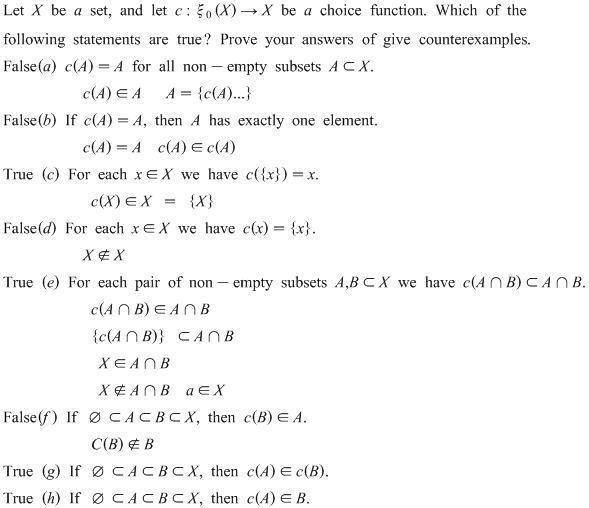

Herewith attached is an assignment that I did. It relates to choice functions. I am not sure if I 've done it right, but I don't know how to prove or give counterexamples to the last two statements. Note that the subsets are supposed to have an equal sign underneath.

For the other problems, what does [itex]\xi_0[/itex] mean?

[itex]\xi_0[/itex] actually looks like a curly B; I don't know how to write this symbol in Latex.
[itex]\xi_0(X)[/itex] = {A: A not equal to [itex]\emptyset[/itex] and A [itex]\subseteq[/itex] X}
Axiom of Choice: Let X be a set. Then there exists a function c:[itex]\xi_0(X)[/itex] [itex]\rightarrow[/itex] so that c(A) [itex]\in[/itex] for all non-empty subsets A [itex]\subseteq[/itex] X}

It seems like the problems sometimes mean to say {c(A)} instead of c(A), but I guess you must go by exactly what's stated.
(g) should be false. counterexample: A = B = {{}} so c(A) = c(B) = {}.
(h) is true- your proof is just definitions. You know c(A) is in A, so what is the definition of subset?

I mean just regular subsets. A is a subset of B if every member of A is also a member of B. The problem says A is a subset of B, so every member of A is also a member of B. c(A) is a member of A, so c(A) is also a member of B.
I think that I was wrong before; is e. false too? If so, is the proof that I already put under there correct? For f. I think that I need a counter example. Is it okay if I put if A [tex]\subseteq[/tex] B, then c(B) [tex]\notin[/tex] A. But c(B) [tex]\in[/tex] B.

I don't understand your proofs; You would need to include some explanation between formulas (at least "implies", "equals", etc.).
e) Does your theory include individuals (or urelements, i.e., objects that aren't sets (or classes)) or do you just have sets? If you have individuals, your proof is easier: [itex]c(A \cap B)[/itex] may be an individual, so it wouldn't be a subset because it wouldn't be a set. If you just have sets, let 0 denote the empty set and let [itex]A \cap B[/itex] = {{0}} ([itex]A \cap B[/itex] has exactly one member). So [itex]c(A \cap B)[/itex] = {0}, and the only subsets of [itex]A \cap B[/itex] are {{0}} and 0. Generally, a set with exactly one member has two subsets: itself and 0. So choose a set S with exactly one member m such that m is neither S nor 0; Then c(S) = m is not a subset of S. Of course, there are other ways, but I think this is the simplest.
f) Does [tex]\subseteq[/tex] mean proper subset? Let A be a proper subset of B. Then there exists some x in B such that x is not in A. Counterexample: c(B) = ?

Right. c(B) is just any member of B. If A is a proper subset of B, then there exists some x in B that isn't in A, so c(B) can be that x. But you said:
"C(B)=B, therefore C(B) is a member of B."
1) c(B) doesn't necessarily equal B - it doesn't follow from anything else stated. c(B) is a member of B. The only way c(B) could equal B is if B were a member of itself.
2) It doesn't follow that for any sets A and B, if A = B, then A is a member of B. If that were so, since every set is equal to itself, every set would be a member of itself! So, for instance, you couldn't have the empty set, which I already know you have.
3) Sets usually aren't allowed to be members of themselves. Do you have the Axiom of Foundation (a.k.a Axiom of Replacement) (you probably do)? If so, your theory doesn't allow sets to be members of themselves. So c(B) couldn't equal B.
4) You already know that c(B) is a member of B- it's part of the definition, so you don't need to derive it. Your counterexample is just the case that A is a proper subset of B and c(B) is the member of B that isn't in A.
