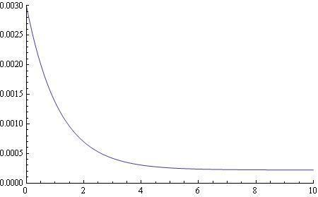

Here's what I did, I solved it via NDSolve with initial conditions alpha=0.505, beta=0.003, gamma=0.98, from x=0 to 10, then plotted beta. The plot below is what I got. How is that not what you want?
Code:
mysol = NDSolve[
   {Derivative[1][\[Alpha]][t] == -\[Beta][t],
    Derivative[1][\[Beta]][t] ==
     -0.89*\[Beta][t] + 0.05*\[Alpha][t]^8,
    Derivative[1][\[Gamma]][t] ==
     \[Gamma][t]*(\[Alpha][t]^8/8.9),
    \[Alpha][0] == 0.505, \[Beta][0] == 0.003,
    \[Gamma][0] == 0.98}, {\[Alpha], \[Beta], \[Gamma]},
   {t, 0, 10}]
myplot = Plot[Evaluate[\[Beta][t]] /. mysol,
   {t, 0, 10}, PlotRange ->
    {{0, 10}, {0, 0.003}}]\
