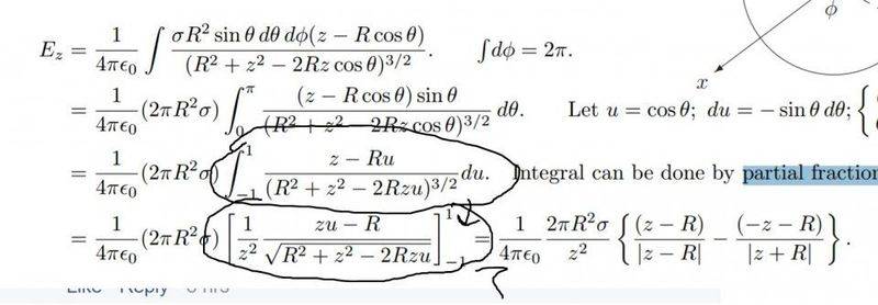

Sorry, how to integrate this function from step1 to step 2

Sorry how to integrate this function from step1 to step 2(see the circle inside the picture)
it looks too complicated
i can't help with it
i cannot use partial fraction to do because it looks hard to decompose it
thank

I thought partial fractional decomposition required both numerator and denominator to be polynomials?
Likes garylau
We're trying to integrate
[itex]\frac{z-Ru}{(R^2 + z^2 - 2Rzu)^{\frac{3}{2}}}[/itex]
We can rewrite this as:
[itex]\frac{R}{(2Rz)^{\frac{3}{2}}} \frac{\frac{z}{R} - u}{(\frac{R^2 + z^2}{2Rz} - u)^\frac{3}{2}}[/itex]
Now [itex]\frac{\frac{z}{R} - u}{(\frac{R^2 + z^2}{2Rz} - u)^\frac{3}{2}}[/itex] is of the form
[itex](A-u)(C-u)^\alpha[/itex]
with [itex]A = \frac{z}{R}[/itex], [itex]C = \frac{R^2 + z^2}{2Rz}[/itex], [itex]\alpha = \frac{-3}{2}[/itex]
Here's the general way to integrate such expressions:
Rewrite this as:
[itex]((A-C) + (C-u))(C-u)^\alpha = (A-C) (C-u)^\alpha + (C-u)^{\alpha+1}[/itex]
We can easily integrate these terms, to get:
[itex]-\frac{A-C}{\alpha+1} (C-u)^{\alpha+1} - \frac{1}{\alpha+2} (C-u)^{\alpha+2}[/itex]
[itex]= -\frac{(C-u)^{\alpha+1}}{(\alpha+1)(\alpha+2)} ((A-C)(\alpha+2) + (C-u)(\alpha+1))[/itex]
[itex]= -\frac{(C-u)^{\alpha+1}}{(\alpha+1)(\alpha+2)} (A (\alpha+2) - C - u(\alpha+1))[/itex]
So if you plug in our known values for [itex]A, C, \alpha[/itex], you should get the desired result (after some simplification).
Likes Battlemage! and garylau

where is this form
coming from
and Where do you got [itex]((A-C) + (C-u))(C-u)^\alpha = (A-C) (C-u)^\alpha + (C-u)^{\alpha+1}[/itex] this equation from?
thank
garylau said:
where is this form
coming from
He's just substituting there. A and C are the two terms that have r and z in it. In the first step he just rearranged it to get u by itself in both the numerator and deniminator, so that he could make the substitution.
The second part is just adding and subtracting C, and then using the associstive property. You'll note that A - u = A + C - C - u.
Likes garylau
Honestly that's a really clever trick and I think I'm going to commit this one to memory.
garylau said:
where is this form
coming from
thank
I suspect both of those relationships came from a book of integrals.
Likes garylau and Greg Bernhardt
garylau said:
where is this form
coming from
The integrand is (after factor out the factor [itex]\frac{2R}{(2Rz)^{3/2}}[/itex]):
[itex]\frac{\frac{z}{R} - u}{(\frac{R^2 + z^2}{2Rz} - u)^{3/2}}[/itex]
That's the same as:
[itex](\frac{z}{R} - u)(\frac{R^2 + z^2}{2Rz} - u)^{-3/2}[/itex]
Now, let [itex]A = \frac{z}{R}, C = \frac{R^2 + z^2}{2Rz}, \alpha = -3/2[/itex], so you get
[itex](A - u)(C - u)^{\alpha}[/itex]
...and Where do you got [itex]((A-C) + (C-u))(C-u)^\alpha = (A-C) (C-u)^\alpha + (C-u)^{\alpha+1}[/itex] this equation from?
Battlemage! explained it above.
Likes garylau
But the temptation to integrate with respect to ##z## (since ##(z^2-Rzu)'=2(z-Ru)##), then integrate with respect to ##u##, and then differentiate with respect to ##z## is just irresistible...
Likes Battlemage! and stevendaryl
Ye gads, is this not cheating? Would that actually work, and if so is it easier?
It feels so good, that it probably is...
The integrals in the intermediate steps are much easier, in my opinion (or, maybe, more obvious). In the end you just differentiate a simple fraction, it's not too hard.
Likes Battlemage!
