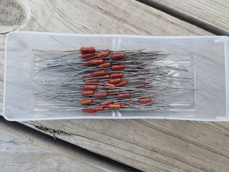

Can any one give me a source for these resistors please?

Thanks for the replies guys, I have been searching for a supply in England with no luck, other suppliers will not sell in small numbers.

What's special about Dale? What are the specs you are trying to match?

I am told that Dale resistors have low noise and are the best for guitar amplifiers, I am not sure that is right but I would rather err on the on recommendations.
Sounds like an Urban Legend to me. AFAIK, all resistors give you the 4kTRB type of noise:
https://en.wikipedia.org/wiki/Johnson–Nyquist_noise
Unless the resistors have built-in bandwidth (B) limiting <something> like high parasitic capacitance, I don't know where that idea came from.
It goes back to the time when carbon composition resistors reigned supreme. A wirewound Dale (with mostly thermal noise) is noticeably quieter than a carbon comp which also has plenty of contact noise, and shot noise.
Thinking back, my 70's era Bassman 50 was built using mostly carbon comp. I don't know when manufacturers began changing to metal film, but they are nearly as quiet as wire wound (and not nearly so inductive), and would have obviated the need.

Regardless of the noise thing. If you only need a few selected resistances, I have a some I'd be willing to give you.

Thank you for the offer Digoff, but I have found a source and ordered my resistors :biggrin:
