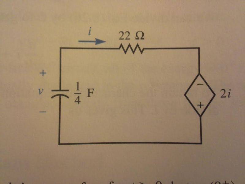

1. Homework Statement
For the following circuit, use KVL to write a differential equation in terms of current i and solve for the source-free current response if v(0+) = 40 V.
$$(s-s_1)Ae^{st}=0$$
$$i=C(d/dt)v$$
$$v=Ae^{s_1*t}$$
$$i=(-1/R)V_0e^{\frac{-t/}{RC}}$$
[/B]
Finding the initial current is not so difficult. We have: $$-40 +22i-2i=0$$, for an initial current of 2 amps.
I came up with: $$(4)i-22(d/dt)i+2(d/dt)i=0$$, thus with 4/24, we have $$s+1/6=0$$.
However the answer is $$2e^{-\frac{1}{5}t}$$, meaning that s_1= 1\5, not 1\6!
I assume the two and the four have to be the same sign, because they are both voltage sources that are lined up with each other such that their voltage becomes greater rather than lesser. However, this means that s_1 becomes positive, or the sources of voltage in this circuit (ie, the capacitor and the dependent voltage source) have different signs!
Alas, s_1 is negative as expected. Therefore, I must be missing something.
What am I doing wrong?
Wait... is it because any component with $$d/dt$$ is going to be negative in a stable circuit?
Not sure I understood everything you wrote, but your equation here has the wrong polarities.
I also don't follow how you solved your diff. eq.
k_squared said:
I came up with:
I think this simplifies to
(4)i - 20(d/dt)i = 0
so there's your 5.
But haven't you inadvertently swapped i where you should have v here?
