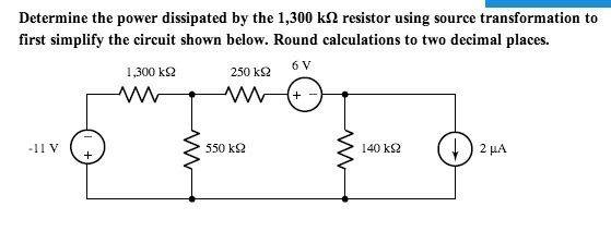

Image Attached
Ohm's
Combined the two resistors in series : 250 + 550 = 800 kΩ
Source Transformation (Current Source): V = 140,000(2*10^-6)= 0.28 V
Combine the voltage sources : 6 - 0.28 = 5.72 V
But then I recreated the circuit with these figures and it just doesn't appear correct to me.
Voltage source = 5.72 V
Resistor = 800 + 140 = 940kΩ
Ans: V = 3.35 V R = 228.19 kΩ
I don't see how they're getting these figures.

Can someone please explain to me what is going on here?

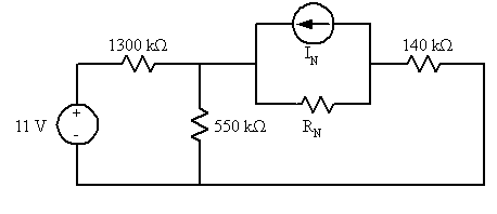

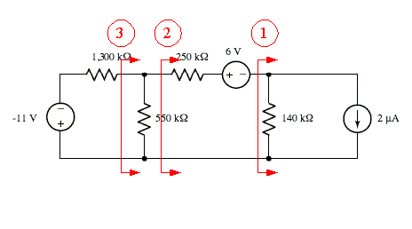

The 250 k and 550 k resistors are not in series: there's another connection at the node where they join (the 1300 k resistor) so they cannot be in series.
Your transformation of the 140 k resistor and 2 uA source to a voltage source (Thevenin equivalent) is fine, and combining it with the 6 V source to yield a net 5.720 V source is good too. What's the Thevenin resistance for that new combined source?
Your next step should be to incorporate the 550 k resistor, so another Thevenin equivalent voltage and resistance should result. You should end up with the original -11 V source, the 1300 k resistor and the new Thevenin resistance and voltage all in series.
The steps are summarized in the following figure. Working from right to left, convert and combine/incorporate components into Thevenin equivalent models as you go:

you've opted to transform to a Norton equivalent, but didn't include the 140 k resistance that is also in series with the voltage source. That means you would end up with something like this instead:
In this problem you have the option of just sticking with Thevenin equivalents all the way through.
