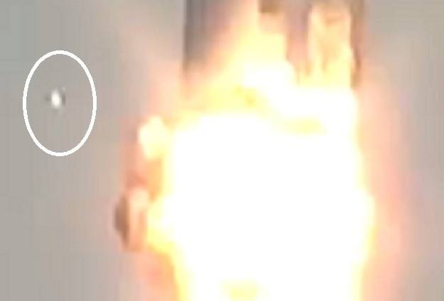

Jonathan Scott said:
On that sort of time scale? I think it's a bug flying past the camera.
at highest resolution there's several of them, some appearing for only one frame.
makes one wonder if this camera's sensor makes a true instantaneous capture or if the pixels are scanned sequentially, like old fashioned kinescope
If:
these are something real not an electronic artifact, and they're the same thing,
it was behind the fireball for two scans
are they some really fast moving things , or 'bad pixels' ?

I did see a couple of what appeared to be bugs, but everything else that wasn't shrapnel, I tend to think was bird movements, especially after things settled down a bit.

You don't see small dark objects in front of very bright objects well with a camera.

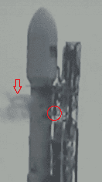

  • #51
What is this mist that get out of the top and the bottom at the very beginning and till the explosion? Is that liquid nitrogen ? And what is it used for ?
It's water vapor - condensed out of the air by cryogenic liquids.

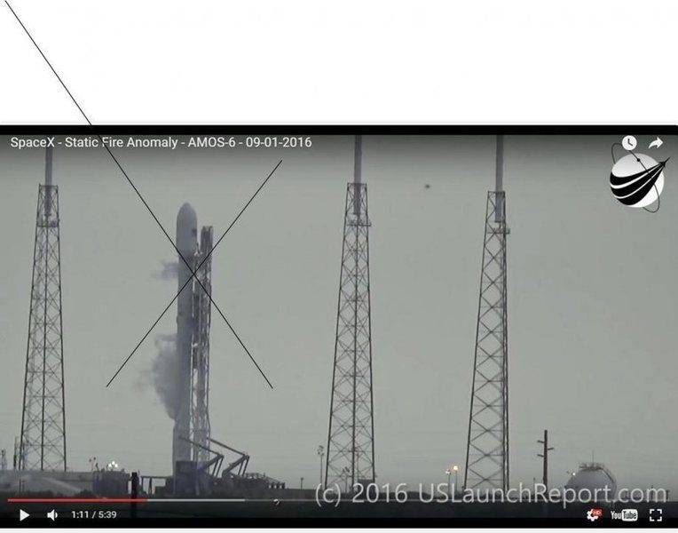

Excellent forum. Here is a graphic from reply #751 in that thread.
The point is that the initial "explosion" seems to be aligned with the "common bulkhead", the divider between the 2nd stage LOX and RP tanks.
Several posters in that thread have cited the very energetic blast seen in the first couple of frames as evidence that the source must have been from within the rocket. Although none have specifically mentioned the frame propagation issue.
Likes liometopum

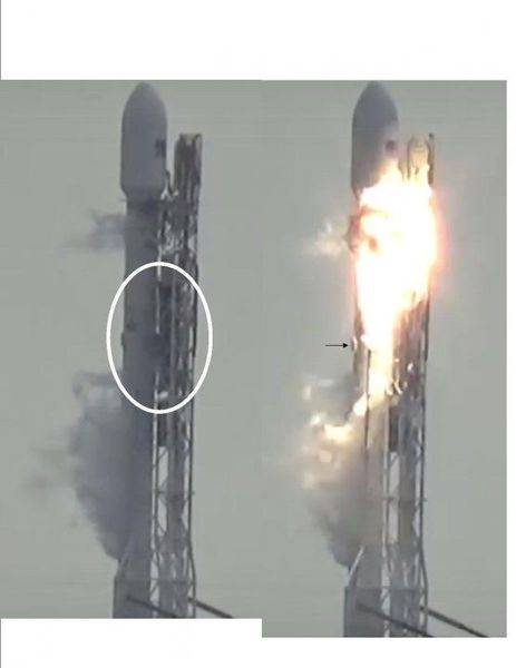

  • #55

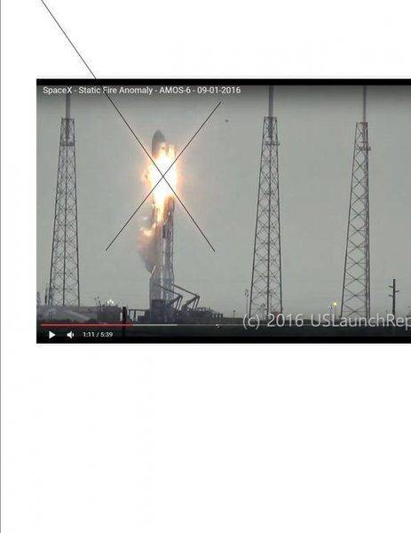

Here is an X drawn on the first frame of the explosion to match the X of light produced:
ll
  • #56

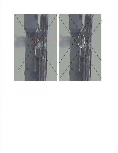

Here is where the X is located on the rocket before the explosion (the last frame before explosion). Using the X of light places the point slightly higher than in the image .Scott posted.
Why is everyone assuming the cause was in the rocket? The crosses marked also coincide with the bottom of the dark pipe between the main gantry and the outer casing which is clearly venting something. This image is the last before the explosion. If that vented material was coming from the gantry and detonated, blowing a hole in the side of the craft (it is designed for internal pressure, not external), then who is responsible for the gantry and launch facility?
Likes liometopum

  • #61
Here is my hypothesis.
What we (think) we know:
1. The explosion appears centered on the connection between the rocket and the pipe. The explosion was external to the rocket.
2,. They were fueling the F9 at the time of the explosion.
So... is that pipe the place where the fuel is was being added?
Also observable:
3. The wind is blowing from right to left, as shown by the clouds of gas emitted by the F9.
4. Most rocket explosions look different, as they start slower. This started in an instant, less than 4/100 of a second, without any prior visible indication.
5. The first explosion frame shows fireballs far down the rocket, beneath the point of explosion..
6. Those fireballs are on the left side, in the vapor clouds.
7. The ignited gas, at these lowest levels of initial flash burn, have a story to tell.
7a..Looking at the first few explosion frames shows that these fireballs are separated, somewhat.
7b. The vapor burn is within the pre-existing clouds of vapor.
7c. The vapor burn areas follow the contour of the vapor clouds, That is, where the clouds are farthest to the left, so is the flash fire.
7d. There is no flashing or burning outside the vapor clouds.
7e. That means the volatile gases were already there, in the vapor; they were not pushed there from the point of the initial explosion.
7f. Even the vapor cloud directly to the left of the point of explosion flashes.
7g. The lowest areas of vapor clouds do not ignite. That probably helps us time when the fuel began leaking.
Hypothesis:
There was a leak in the 'fuel line to rocket' connection, Fuel was escaping for some time, prior to the explosion. Being heavier than air, the fuel vapors sank, and were carried to the left by the wind. The wind speed was variable, causing a contour of vapor to the left, and below, the point of emission of the fuel vapor (which was mixed with the other emission gases). Somewhere down lower, below the point of leakage, static electricity, or rubbing between parts, caused a spark, and that ignited the volatile gas which flash-burned outwards in all the directions it could. The flash went out to the furthest point in the vapor clouds containing fuel, and burned up to the point of leakage. There, at the leak, it ignited the fuel where it was leaking directly from the 'fuel line to rocket' connection and, due to high density of fuel there, burned hotter and faster and produced the explosion.
  • #62

  • #64
First, let me tell you why "everyone" is assuming that the cause was with the ground support equipment. It's because the giant X drawn by the lens flare falls right at the right edge of the rocket - near the GSE. But this hardly rules out the rocket, as described below.
In the first frame showing flames (frame #1), flames are propagating at least 8.5 feet in no more than 40msec - and that doesn't include the velocity component towards the camera. To achieve this, an ignited fuel/oxygen mix needs to be ejected at hundreds of feet per second. There is no source for this mix at the tower - certainly not in the quantity seen.
The direction of this burst is towards the camera - but since the X is falling to the right of the rocket center, it must be ejecting somewhat to the right.
But we know something more about that mix. For the most part, it does not appear to be "chunks" of anything - rather it is a spray. The primary indication of this is in subsequent frames, frames #2 to #4. What we see in those frame is that the original burst is arrested - presumably by traveling through air, and there is not a sea of fragments emitted from the spray. Although, of course, we do see larger, non-burning fragments.
So that initial (frame #1 and #2) burning mixture is fluid - entirely or almost entirely.
  • #65
