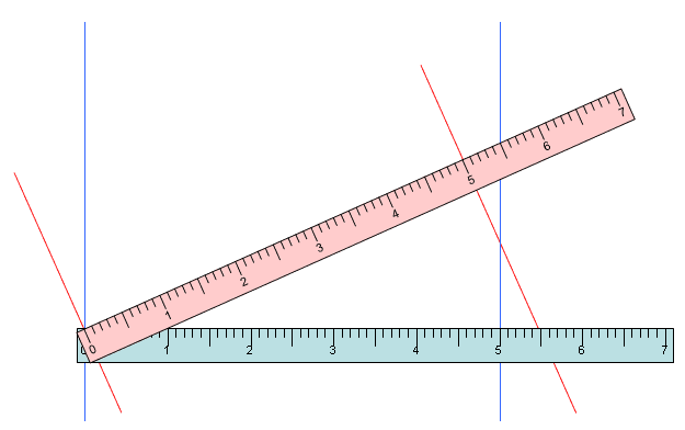

  • #62
JM,
There is an analogy to be made between clocks measuring time and rulers measuring distance. Consider the diagram below. Do the two rulers both measure distance in the same way? The two rulers are both "synchronised" at their zero marks. Are they still synchronised at their "7" marks? Do they both measure "at the same rate"? Does one measure more distance than the other?
For instance, the blue lines seem to indicate that 5 blue units are equal to 5½ red units. On the other hand, the red lines seem to indicate that 5 red units are equal to 5½ blue units.
So is the red ruler "running short" compared to the blue ruler? Is the blue ruler "running short" compared to the red ruler?
You might think this example has little to do with clocks and time. But if you look at the mathematics behind my example and compare it with the mathematics behind Lorentz transforms and relativity, you will find that the two cases are really quite similar.
