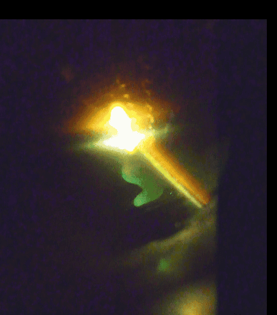

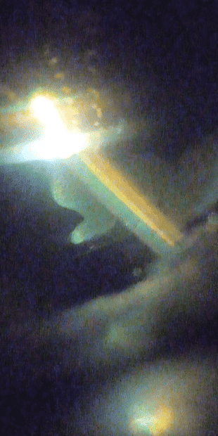

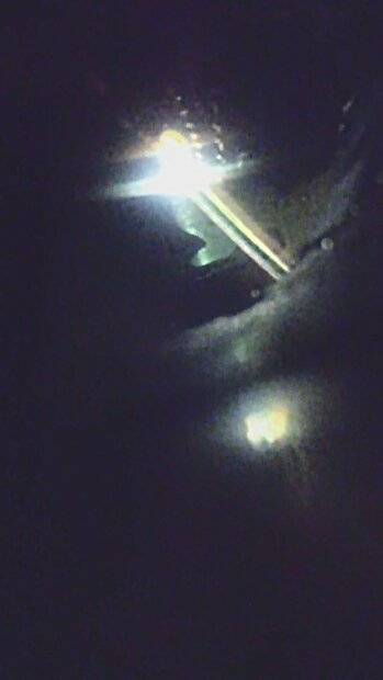

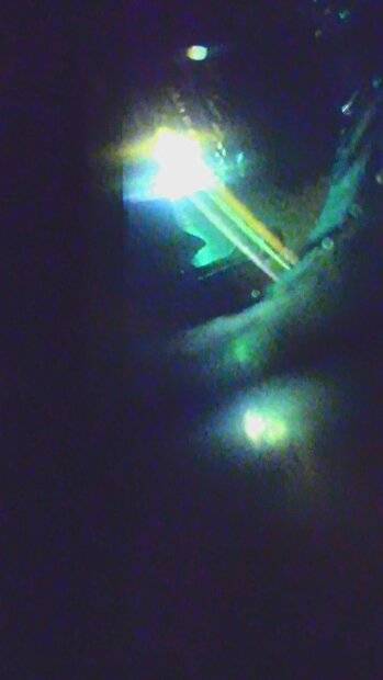

Hello, I'm working on building a particle accelerator. There is a 6mm Quartz Sphere stone located near the target where electrons collide producing what I'm assuming to be an emissions/absorption spectrum of some sort? I'm really new at science in general. I'm just wondering if anything (elements, energy levels,etc) can be identified by the lines being emitted from the crystal.

Right now i do not have a vacuum set up, I have been working on a housing so I can accomplish that, so right now it is just open/exposed to atmosphere. The target area is approx 4 cubic inches. I disassembled a car battery and made many 1 inch thick sealed Lead blankets, in between the blankets I also have 1 inch thick wax blocks and sitting in front of all of that I filled up empty milk bottles with water because I was getting readings on the Geiger counter of 1000CPM intermittently, there was some spikes a few times at 2000 and 3000 CPM. The voltage of the power supply is 20,000 volts.
A, You should look up x-ray fluorescence.
B. If you are trying to accelerate electrons in air, you probably can't. Sure something else may be happening, heaven knows what.
As a rule. the order is study, design, construct and operate, in that order.
C. Lots of people come here saying they want to build a particle accelerator. Few if any do it safely. Most end up getting their threads closed.

Thank you so much for replying and trying to help me out! I'm really not trying to come here to find out how to build one as I already have the set up I'm using. I'm more or less trying to get ideas of what some of the products I'm seeing that are being produced are, e.g ( the straight lines emitting from the stone, radiations, etc... ) I definitely don't want to have any of the threads I post closed. What causes people to have the threads closed?

Because the Mean Free Path of an electron or ion in the atmosphere is very short. That will prevent accumulation of energy in the one particle alone, the one you assumed was being accelerated.

Neutrons?
Hmmm...
Why do you think you have (or even want) neutrons? Nuclear binding is typically 8 MeV per nucleon, so you need a few MeV to produce neutrons? (You probably aren't running the exceptions like deuterium, tritium or uranium, and in many cases you sure shouldn't be.(
The Fermilab LINAC has a gradiant of about 1 MeV/m. A reasonable goal might be half that, so 8 MeV means 50 feet long. Are you starting with something so big? If so, why?
Further, x-rays are coming off everything with high voltage, not just the target, If you have a kilovolt to ground, you will have x-rays. How many? Maybe not many, maybe a lot. You have to measure them.
