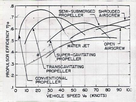

    How could I express the speed of an object as a function of time if the object is accelerating with a constant power output and is being affected by quadratic (Rayleigh) drag?

    As a start, I would draw a free-body diagram and add the relevant forces. Since it is a submarine, the power produced by the propulsion machinery is converted into thrust, either by turning a propeller or by means more exotic. The drag is proportional to the velocity squared and acts to oppose the thrust. Since the sub is accelerating, then T - D is positive, and T - D = m a, where m is the mass of the submarine, and a = dv/dt.

    And in general the thurst will not be constant for constant power input, but depend on the speed.

    And that's the point where I got stuck. I found an equation that works if the thrust is constant but that is not the case here.
    Perhaps if I expressed drag as a loss in energy (speed3) it might be simpler.
    Not quite sure though, we haven't done anything like this at school so far and it might be a few years till we do.

    You won't get an analytic solution for this. The thrust itself is not some simple function but usually derived empirically or numerically. You have a chart like this:
    And get the thrust by:
    thrust = (efficiency * shaft_power) / velocity
    To get the speed as function of time you have to integrate the acceleration from the net force (thrust - drag) numerically. For low velocities there is static thrust data.
