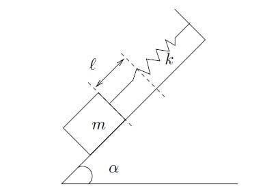

The mass m is attached to a spring with spring constant k, on incline which forms
the angle α to the horizontal. The mass is stretched into the distance ℓ from the equilibrium position
the spring and kept there. How far up the incline can the mass go after
it is released, if friction is negligible?

start with setting up all the forces working just as you release the spring. At first, the spring force F(x)=-kx, (x in the direction of the plane) will be greater than the projection of gravity, but as x gets smaller, gravity will win (or even the spring might contract and push back).
X-direction:
F = ma= -m*g*cos(theta) - k(-x)
agree so far?
