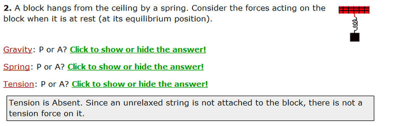

why is tension not present here?
(I don't understand the explanation given)?
I don't understand the choices. There are two forces acting on the hanging mass: gravity and the force from the spring. Of course, a stretched spring exerts a tension. So I don't know the intention of having 'tension' vs 'spring' as separate choices: you could call that force the spring force or the tension force exerted by the spring.
And the given explanation reads like gibberish. Where is this question from?
