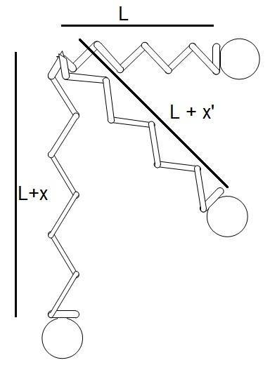

You have a pendulum with a ball of mass m at the end, and the pendulum is held parallel to the ground. This pendulum is also a spring, however, with spring constant k and equilibrium length L. You let go of the weight. What is L', the new length of the spring at the bottom of the swing, and what is the velocity of the ball?

Since the spring will be extending as the pendulum swings downward, both its radial and tangential components will change; and you will end up solving two ODEs. You will need to solve the radial ODE in order to determine L'.
Once you know L', then you can use CoE to determine the velocity. I recommend setting the problem up such that the height of the mass at its lowest point is defined as zero, so that the final gravitational potential energy is zero and the initial GPE is mgL'. You will have to resolve the Forces that act on the mass into both tangential and radial components (or, alternatively x and y components).

The question here is quite ambiguous. There are two possible meanings, it could be asking for the length of the spring when it is directly below the pivot point, or it could be asking for the length of the spring when the mass is at its lowest point. These will not necessarily be the same because the lowest point occurs when the velocity is horizontal but there is no reason for the velocity to be horizontal when the spring is vertical because the spring's length can change.
However you interpret the question though I don't think your method works, because your centripetal acceleration method only applies when the motion is a circle, which isn't the case here. If you try to apply it here there will be too many unknowns.

Do you see in figure that ball is at lowest point when spring is vertical.
You are going too deep in question ...
and IMO the spring will be vertical when ball will have only horizontal speed.
centripetal acceleration is not just about circular motion ... even elliptical and helical motions have centripetal acceleration. what makes some motion with non circular is that either their centripetal acceleration is not constant or they also have some tangential acceleration ... and still you can use centripetal acceleration at some point of your motion .. provided that the length from center and tangential velocity is known.
Drawing a picture of what you think doesn't make it right. You could be right, there might be a physical argument I've overlooked which means that the velocity has to be horizontal when the spring is vertical, but I'm not going to believe that until you give me the argument.
Your intuition is obviously telling you that the velocity will be horizontal, but my intuition tells me it won't be. Take an extreme example and imagine doing this experiment with a very heavy mass and a very weak spring, if I picture that in my head it seems like the mass should just plummet downwards very quickly and reach its lowest point before the spring has a chance to become vertical, when it is vertical the mass will be on its way back up having already reached its lowest point.
Alternatively, imagine a very long pendulum so that its natural period is far longer than the natural period of the spring. If you set that going with with small amplitude oscillations you are going to have the spring going up and down many times within each pendulum swing, so there's no reason for the lowest point to occur when the spring is vertical.
I'm aware that centripetal acceleration arises whenever you describe something with polar coordinates. However, if the motion is not circular then there will be more to the radial acceleration than just the centripetal acceleration. You can't set the radial acceleration equal to the centripetal acceleration as you tried to do in your original post by writing the incorrect equation:
