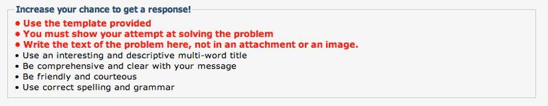

Don't give me your indignation, man. You were supposed to use the template for posting homework help threads, the one that requires an *exact* problem statement and an attempt at the solution. You know, the template that you deleted when you made your original post, in spite of being asked in boldface red text to use it? Didn't you see this above the compose window?
So your post is in violation of PF rules, and by all rights I should delete it. But I'll let you off this time.
