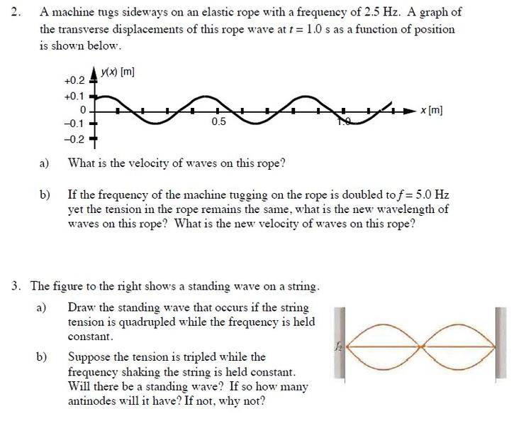

see question 2a, b
a) v=f(wavelength)
b) v= sqrt(F/(m/L))
a) f=2.5 Hz, t=1.0 s and one wavelength on the graph is I guess 0.4 m?
v=2.5(.4)=1 m/s
b) f=5.0 Hz, tension same
v= sqrt(F/(m/L)) means that a change in frequency will not change the velocity?
1=5(wavelength)
wavelength= 0.2 m?
see question 3a, b
fn=(n/2L)(sqrt(F/(m/L))
a)since this is a second harmonic, f2 = 2(2/L)(sqrt(F/(m/L)) = (1/L)(sqrt(F/(m/L))... wavelength = L
quadrupling F would mean that f=(1/L)(sqrt(4F/(m/L)) = (2/L)(sqrt(F/(m/L))
since f does not change, only way that these two will be equal is if the above is divided by 2
(2/2L)(sqrt(F/(m/L)) = (1/L)(sqrt(F/(m/L))
thus wavelength = 2L, so the new picture should just contain half of the wave?
b)tripling tension would mean that wavelength = sqrt(3)L... this shouldn't be possible right? since a standing wave needs to be connected at both ends (nodes) and having a wavelength of 1.7L would not connect on one end...please help! thanks
I think you should start off by looking at the first calculation. You've picked up an extra factor of 10 somewhere.
edited, but do things seem right or are they wrong 2b and 3a, b are the ones I am not sure on
