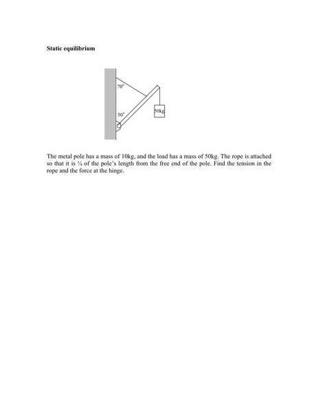

The metal pole has a mass of 10kg, and the load has a mass of 50kg. The rope is attached so that it is ¼ of the pole’s length from the free end of the pole. Find the tension in the rope and the force at the hinge.

I have tried to set up this problem but would like some feedback.
I want to set my vector diagram with the origin placed at the hinge point, with y+ upwards and x+ going to the right.
[tex]\sum[/tex] [tex]\tau[/tex]=0
T(3/4)sin20 - 98N(1/2)sin50 - 490(1)sin50 = 0
T(3/4)sin20 = 412.8979548
T = 188.29 N
If I am right with the value for tension, then to find x and y components of force would be:
[tex]\sum[/tex] Fy = 0
Ay - 98 - 490 + 188.29sin20 = 0
Ay = 523.7 N
[tex]\sum[/tex] Fx = 0
Ax - 188.29cos20 = 0
Ax = 176.93 N
Am I on the right track?
