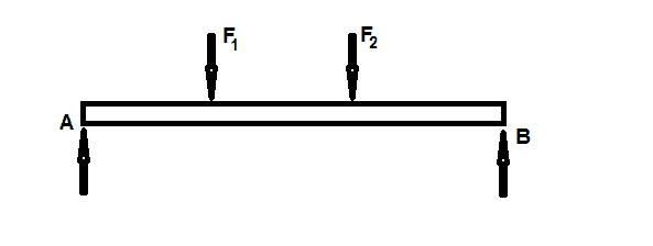

To show you the basic process, I'll walk you through a simpler example, given by this image:
Lets say we have two forces, [tex]F_1[/tex] and [tex]F_2[/tex] that are evenly spaced along a beam of length L. (For this, we assume that the mass of the beam is negligible. Sometimes the beam is given a mass; it acts at the center of mass.) There are simple reaction forces acting at A and B. That is, there is just a force in the vertical direction at each point.
The beam is in static equilibrium, so the following equations hold:
[tex]\Sigma \vec{F}=0[/tex]
[tex]\Sigma \vec{M} = 0[/tex]
We have two unknowns, A and B. Recall that the definition of the magnitude of a moment is [tex]M=Fd[/tex], where F is the magnitude of the force and d is the length of the moment arm, which is the distance between the line of action through the force and the line through the point which the moment is about.
(More generally, [tex]\vec{M}=\vec{r} \times \vec{F}[/tex], the cross product of the position vector and the force vector.)
If we take the net moment about one of the points, the reaction force at that point will produce no moment. This will give us an expression we can solve for the other reaction force.
I'll find [tex]\Sigma M_A[/tex], the net moment at A:
[tex]\Sigma M_A = F_1\frac{L}{3}+F_2\frac{2L}{3}-BL[/tex]
This has to equal zero for it to be in static equilibrium, so:
[tex]0 = F_1\frac{L}{3}+F_2\frac{2L}{3}-BL[/tex]
[tex]BL= F_1\frac{L}{3}+F_2\frac{2L}{3}[/tex]
[tex]B= \frac{1}{3}\left( F_1 + 2F_2\right)[/tex]
Now that we know B, we can use ∑F=0 to find A. There are no forces in the x direction, so we only need to look at the y direction. This gives:
[tex]\Sigma F_y = A+B-F_1-F_2[/tex]
Letting ∑F=0 and solving for A gives:
[tex] A= F_1+F_2-B[/tex]
[tex] A= F_1+F_2-\frac{1}{3}\left( F_1 + F_2\right)[/tex]
[tex] A=\frac{1}{3}\left( 2F_1 + F_2\right)[/tex]
Generally, you want to do the following:
1. Draw a diagram showing the forces.
2. Apply ∑M=0 through the point that eliminates the most unknown forces and solve for the remaining unknowns.
3. Apply ∑F=0 to solve for the remaining forces.
For your second problem, you have a part of the beam where a uniform load is applied. Calling the linear load density [tex]\lambda[/tex], the force it applies is given by [tex]F=\lambda d[/tex], where d is the length along which the load is applied. The load can then be treated as a point mass halfway between the points where the load is applied.
