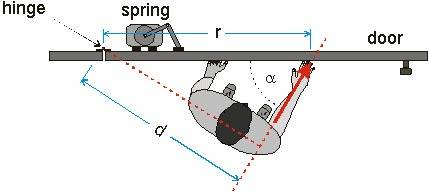

No, you need the perpendicular distance, d, NOT r, between the line of action of the force and the point you are rotating about. See the picture for example.
Am I supposed to use r and theta to find d? I'm still confused.
No you have to find out what the distance is from point you are rotating about for example and the line of action of the force. For example if your force goes through the origin then the distance between the origin and the line of action of the force is 0, because as it goes through it the distance between them is 0.
Take a look again at the red arrow in the picture. That is the force. You have to extend it, that is the dashed red line and figure out the shortest distance to your point you are rotating about. That is the other dashed red line,d.
In your case you have to extend your force as well and you get your line of action of your force

You know that it is perpendicular to your line of action and it goes through the origin. Two pieces of information that should be enough to know what that line is. The intersection of that line with your line of action is the point you are looking for. And the distance from that point to the origin is your distance. The same can be done for point B
Sorry, I'm still not getting it. Do I need to find the slope of the line of action? I don't know how to find where d intersects the line. I know all three angles in the triangle formed by a line perpendicular to the line of action, but I don't know the lengths of any of the sides. Is there a ratio I'm supposed to find? The length d is the shortest perpendicular distance to intersect the line of action but I'm not sure how that helps me.
Yes you need the slope of both lines. You have your line of action which has the form [itex] y = ax + b [/itex] and the line of the shortest distance has the same form. a is the slope. If you have that you can find their intersection by equating them
