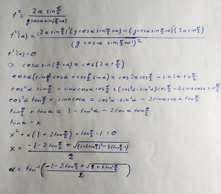

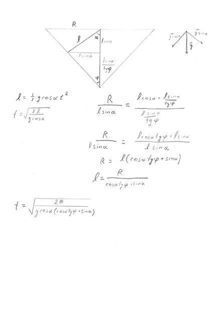

A hollow cone is placed on the ground like shown in example. Inside a cone there is string attached to base center. In the string there is a small bead. What must the angle between string and vertical be, so bead reaches cone surface fastest? (You can stretch the string). Cone base is parallel to the ground and cone has angle φ. String frictionless.
kinematic eqs
trig identites
I tried to come up with expression of time in terms of φ, α, and some constant value of cone size that does not depend on angle (I used R as cone radius). I though I could use that expression to see at what angle time is going to minimum, but I came up with expression from which I can't make a conclusion. I believe there is another solution method, or maybe there are some useful trig identities, but I was unable to find it.
Can someone help me out? Thanks
Angle φ is marked badly at my solution, but that doesn't change anything in particular.

Note that the angle you call ##\varphi## is half the angle given as ##\varphi## in the diagram.
My first approach would be to use the law of sines for the triangle that has angles ##\alpha##, ##\varphi/2## and ##\pi-(\alpha+\varphi/2).## Then minimize ##t^2## with respect to ##\alpha.##
Likes SammyS

So I get t^2=(2 a sin(φ/2))/(g cosα sin(φ/2+α)), a is length OC. How can I minimize it to find value of α?

So after differentiation with respect to α, setting t=0, I get α=90-(φ/2). Could this be the answer?

Yes, previous solution had a mistake. This time I tried to do something like this, but that seems to me that it doesn't make sense too. Because if we set (φ/2)=0, then α=32, which doesn't look right.

I just picked there wrong trigonometry formulas, so I got wrong answer. As I mentioned before, a is length OC in the triangle. I needed that for law of sines.

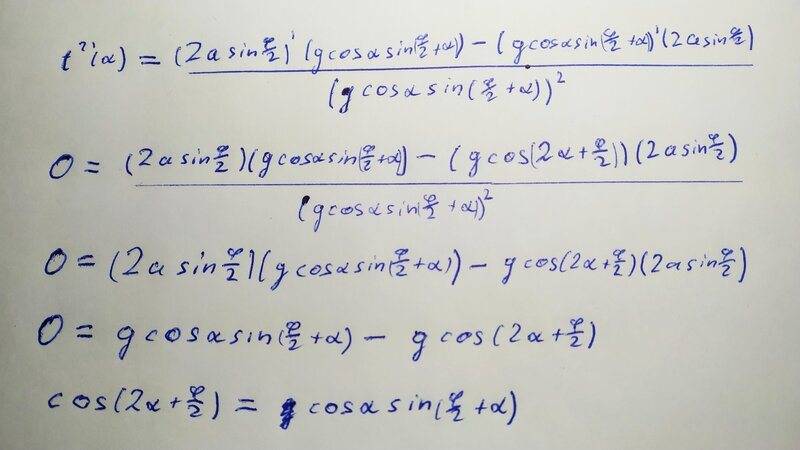

Not sure how you got the line following "=>". Please post the details of that step.
I assume you realise it is only necessary to maximise the denominator in the expression for ##t^2## since the numerator is constant.

I think I'm getting your idea, but how I should write ##x(t)## equation? I suppose that $$y(t)=\frac{1}{2}gt^{2}.$$
Or it should be like $$y(t)=\frac{1}{2}gcos^{2}\alpha t^{2} $$
$$x(t)=\frac{1}{2}gsin\alpha cos\alpha t^{2}$$
Because string length is $${\frac{1}{2}gcos\alpha}t^{2}$$

a and φ are constants, so what is the derivative of ##2a\sin(\phi/2)##?
I see... It should be zero, but whole equation then disappears.
Does it? What do you have left?
Well, should I solve it like that?
$$-gcos(2\alpha+\varphi /2)(2asin(\varphi/2))=0$$
$$cos(2\alpha+\varphi /2)=0$$
$$\alpha =\frac{90^{\circ}-\varphi /2 }{2}$$

Right.
