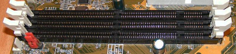

RAM is very easy to install, with the caveat that it must be compatible with your motherboard (the memory controller specifically). It comes in very friendly 'modules', which fit into slots on the motherboard in exactly one way.
http://upload.wikimedia.org/wikipedia/en/b/bc/DIMMs.jpg [Broken]
You simply push apart the latches at the ends of the slot, gently push the module into the slot all the way down, then close the latches to hold it in.
You will want to be careful with static electricity - you can destroy your motherboard with your finger, if there's enough charge built up. Avoid dry weather, wool socks, and discharge any static before handling unshielded electronics - touching a grounded conductor, like the interior of the computer case, will work. It's not hard - I've never destroyed anything with static yet.
Opening a case can be mechanically tricky with brand-name PCs. There's several screws you'll need to unscrew (see your manual). And sometimes there can be sharp metal edges inside - watch out. There is not much space inside a computer, so if you drop a screw it will get lost and give you a headache - magnetic screw tips are useful.
On rare occasions, new memory can be DOA (broken out of the box), which can cause your computer to mysteriously fail to turn on. The usual troubleshooting method should save you - replace the DIMMs one by one to see which one is dead.
One last possible pitfall - watch what you touch inside the case, there are important little switches on the system board which you can accidentally bump into.
