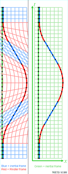

They are the same in any inertial frame on Minkowski space, but we can easily imagine a global coordinate system such that an accelerating object e.g. has x=0 at all times.
I learned recently that some authors actually consider such a coordinate system a part of GR instead of a part of SR. I find that quite bizarre.

  • #69
Hello Al68.
What system of coordinates do you want to use and how would you depict the objects relative to it.
Matheinste.
  • #70
Al68 said:
There's still one thing that I don't have worked out. If we had real acceleration instead of instantaneous, it would be obvious that, from the ship's twin's view, the Earth and space station do not stay at rest with each other. So as the ship starts slowing down, the Earth and space station are getting farther apart. If the ship decelerates at 1 G proper acceleration, is it important that his coordinate velocity and acceleration relative to Earth will be different than relative to the space station?
No it isn't. The reason is that what you're describing isn't a coordinate system. You're describing a one-parameter family of coordinate systems (with proper time along the ship's world line being the parameter). It doesn't make sense to think of this infinite set of coordinate systems as the ship's point of view, not globally anyway. Each member of this set is a coordinate system that we can think of as the ship's point of view in an infinitesimally small region of space-time around the point on the ship's world line that's characterized by the same value of proper time as the coordinate system. We can not think of one of them, or all of them, as representing the ship's point of view in a region of space-time that includes both the Earth and the space station. (I assume "the space station" is the spatial location of the turnaround event in Earth's frame).
Al68 said:
Is there a resolution on the net that shows the math for realistic acceleration?
If you mean, "describes things from the ship's point of view during realistic acceleration", the answer is no. There is no natural way to associate a coordinate system with the ship's world line. (This is not a problem that GR solves. Things are actually even worse in GR).
One thing we can do is calculate the age of either one of the twins at any event on his world line. It's just the integral of [itex]\sqrt{dt^2-dx^2}[/itex] along the world-line. This works no matter what the acceleration is.
