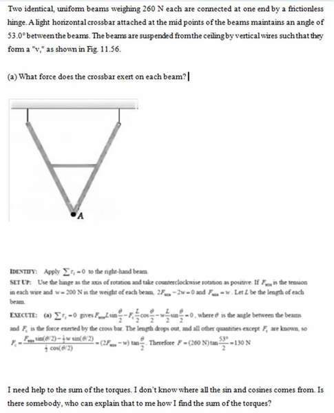

Hi.
I am working on this problem, which I have uploaded as a picture.
I have a question to the sum of torques.
Is there somebody how can explain me where all the sines and cosines comes from.
I am not so good to the find sum of torques.
Well, first start by calculating the individual torques.
