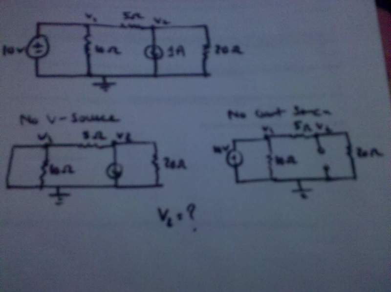

I have to find voltage at point 2 using superposition method. So, I drew one circuit with no voltage source and another with no current source, and then tried to analyze each one separately.
(On the picture starting from left, its 10 volts, then 10ohms, then at top 5 ohms, then 1 amp current source pointing down, then on far right 20 ohms)
For No Voltage Source:
Using Node Voltage analysis at V2:
(V2-0)/5 + 1 + (V2-0)/20 = 0
V2= -4 Volts
For No current Source:
Using Voltage divider formula:
V2 = (5/(5+20))*10 = 2 Volts
Adding the two V2's i get V2 = -2, which i think is wrong.

Hi Tekneek. This line doesn't look right ...
V2 = (5/(5+20))*10
For the no current source circuit isn't V1 10 volts? Then since 5ohms and 20ohms were in series i used the voltage divider formula. Also the 10 ohms resistor and 5+20 ohms are in parallel so they would have the same voltage (10v)?
Voltage divider works 'oppositely' to current divider.
What do you mean by that? Isn't the total voltage across the resistors in series divided?
The rules require I can only offer moderate assistance. Based on where you managed to get in this problem, I think you understand this but are simply not seeing it. Look at what I have attached
**edit that 30 should be a 20, my eyes are not good
Likes 1 person
Oh ok so V2 is the voltage across 20ohms resistor (for circuit with no current source). Thank You!
Yeah that should make sense looking at where you have placed the ground, right?
You're welcome, I am glad you came to that conclusion on your own as well!
