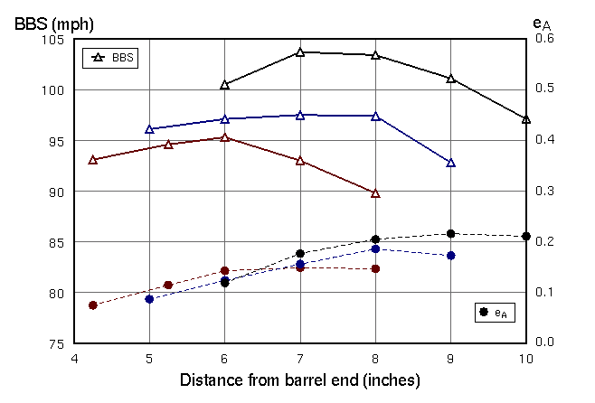

A similar question: The bumper on a pool table is at a height so that the pool ball does not skid when it hits it. How is this described in Mechanics?
It seems that others have studied the baseball bat sweet spot also. Here's a link
https://www.acs.psu.edu/drussell/bats/sweetspot.html
Fig. 6 Comparison of Batted-Ball Speed and collision efficiency (eA) as a function of position for three slow-pitch softball bats: (red) a good single-walled bat, (blue)a high performance double-walled bat, and (black) a very high performance composite bat.
Edit: Here's a 2nd paper. https://www.acs.psu.edu/drussell/bats/bend-sweet.html

  • the location which produces least vibrational sensation (sting) in the batter's hands
  • the location which produces maximum batted ball speed
  • the location where maximum energy is transferred to the ball
  • the location where coefficient of restitution is maximum
  • the center of percussion
  • the node of the fundamental vibrational mode
  • the region between nodes of the first two vibrational modes
  • the region between center of percussion and node of first vibrational mode
