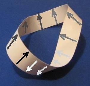

I think the point is that there is no particular meaning to "pointing in the same direction" for vectors at different locations. An extreme case is a non-orientable manifold such as a Mobius strip. If you take a Mobius strip and start drawing arrows on it and you go all the way around trying to draw arrows pointing in the "same" direction, then when you get back to where you started, the arrow will be pointing in the opposite direction of the first arrow. What this shows is that on some manifolds, there is no meaningful notion of arrows pointing in the "same" direction, except locally.
Now, a Mobius strip isn't even curved, from the point of view of differential geometry. The fact that it's not a strip of 2D Euclidean space can only be discovered by going all the way "around". Within any bounded region of the Mobius strip that doesn't go all the way around, you can give a meaning to "same direction" that works in that region. A manifold with curvature is in an even worse situation---you can't even give a consistent meaningful notion of arrows pointing in the same direction in a small region (unless it's infinitesimally small). On a curved surface (such as the surface of the Earth), if you march around a closed loop, and try to maintain an arrow pointing in the same direction, when you get back to where you started, it will have shifted directions a little. A clear example is to start at the North Pole, with an arrow pointing south along the line of 0 degrees longitude. March down to the equator, and your arrow is still pointing south along the line of 0 degrees longitude. Now, go East along the equator to the line of 180 degrees longitude. Go back north to the North pole. At this point, your arrow will be pointing along the line of 180 degrees longitude, exactly the opposite direction from when you started.
Using the same vector space at every point in your manifold just doesn't make sense. In the Mobius strip example, having the same vector space for each point means at every point, having a pair of directions that you can call the x-axis (pointing in the direction "around" the strip) and another direction that you can call the y-axis (pointing from one edge toward the other). But if you try to do that, then at some point, your notion of the y-axis must shift discontinuously.
