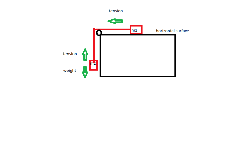

I have uploaded a diagram...In this diagram if m1 has sufficient weight, m2 will not accelerate downwards..Or you can say it as if m2's weight is 'balanced' by equal reactional tension in the string...But if m1 does not have suffiecient weight, m2 will accelerate downwards...Now, why is that so because even now m2's weight should be equal to its reactional tension in the string( Newton third law)?...If the weight has equal upwards reactional tension, should'nt it be 'balanced'?

Your model must include a mention of Friction or else M1 and M2 will always accelerate. The weight force of the hanging mass will accelerate both masses according to N2.
Okay let me explain it like this...The weight of m2 will cause some tension in the string..This tension will cause some net force on m1 (of course if it is greater than its Fs )...So it will accelerate in direction of tension...My basic question is that, if, instead of that mass m1, the string was fixed to some other thing like a wall, it will not accelerate...Because in that case the weight of m2 will be equal to tension in the string...But now in THIS case, the weight of m2 dominates the tension in the string (causing it to accelerate downwards)..So why is that so when weight should still be equal to the reactional tension in the string?
You can work all this out yourself by following the following piece of logic:
1. What is the downward force on m2? (whether it's in free fall, on a table or moving down in your experiment)
2. If the string is not stretching, what total mass is being accelerated by this force?
3. What is the acceleration of the mass in 2, by the force in 1.?
4. What string Tension is needed to accelerate m1 at the rate in 3.?

You are mistaken, in THIS case, the weight is NOT equal to the reaction tension of the string.
You can see this by drawing free body diagrams for the masses.
For simplicity, let m1=m, m2=M, M >> m, and the tension is T.
The table is frictionless, and the string does not stretch.
Then... for m1, mg-T=ma
... for m2, T=Ma
... eliminate a and solve for T in terms of m and M.

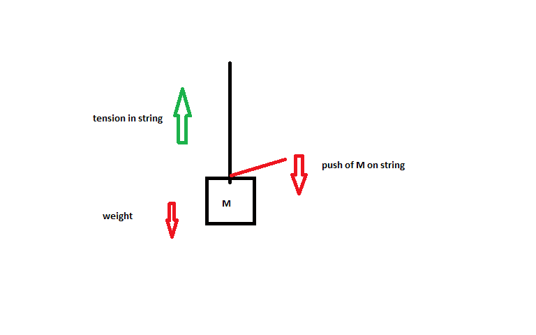

Okay i have uploaded another diagram...According to my understanding, ALL of the forces (represented by arrows) in the diagram are equal in magnitude, whether the body M is accelerating or not...Correct me with some explanation...
That is not correct. Newton's second law applies. If the block is accelerating then the sum of the external forces on the block is
a. Zero
b. Non-zero.
Pick one.
Kaneki123 said:
The two bodies pulling on each other are...the mass m1 pulling on string in downward direction and the reactional tension in string pulling m1 in upwards direction..(correct me if i am wrong)...
You are correct. The third law tells you those two pulls are equal in size and opposite in direction.
Note you could also say the two bodies are the Earth pulling down on m2 gravitationally and m2 pulling up on the Earth gravitationally. Or the string pulling on m1 and m1 pulling back on the string. Or ignore the physicality of the string and say m1 pulls on m2 and m2 pulls equally hard back on m1. (It is not intuitively obvious, but it is important that the tension is uniform in the string. The string pulls equally hard on m1 and m2)

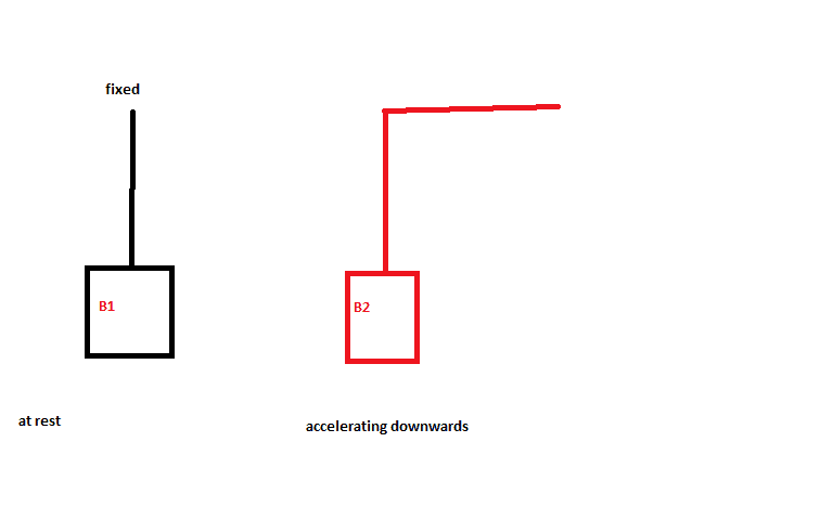

Okay let me state my question like this...The B1 in diagram is at rest because its weight is ''balanced'' by tension in string...The B2 is not balanced because its weight somehow dominates the tension in the string...If this is related to the ''fixed'' end (as in B1) and the ''fixed to body with lower mass''(as in B2) then please explain?If not then please explain how the weight can ''dominate'' the tension in string when it clearly does not do so in B1?

This is becoming very hard work.
That diagram is of no use if you don't say what's on the other end of the string. Without any more information, we can only say that there is no reason to suggest that T is the same magnitude as the Weight force of M. I realize that this is what you firmly believe but it is just wrong and makes no sense, in fact.
I suggest that you read Newton;s First and Second laws of motion (modern / textbook versions will make it easier to understand). Then apply what you have read to your suggested situation. Notice I have not suggested that you should look at Newton's Third Law, which has nothing to do with this diagram.
