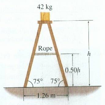

1) A box of mass 42kg sits on the top of a ladder. Neglecting the weight of the ladder, find the tension in the rope. Assume the rope exerts horizontal forces on the ladder at each end.
m1g – T = m1a
T = m1g - m1a
This is the formula i know for calculating the tension
I have mass has 42 kg. But what is the value for acceleration here? Also I dont know because i have values for h and θ in the diagram.

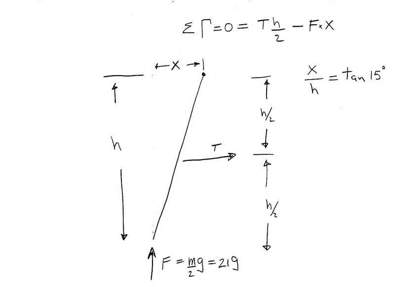

I think you are missing a critical dimension, see,
Edit, not so sure now, think everything is fine.
Spinnor
2,180
391
This is more what you want?
338
Thanks a lot Spinnor. So nice of you in explaining the things so beautifully.
