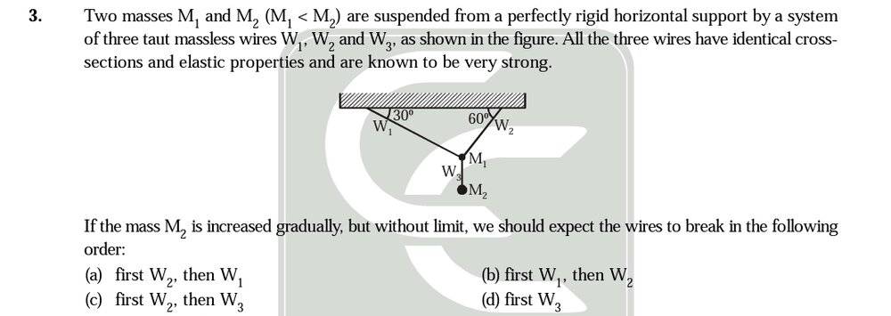

In summary: After I posted what I did above, I realized that I was assuming too much. The best you can do is solve for how the relative tensions change as ##M_2## increases.

The question is added below
##T_1=\frac{(M_1+M_2)}{2}g##
##T_2=\frac{\sqrt 3(M_1+M_2)}{2}g##
##T_3=M_2g##
Attempt:
By drawing the Free Body diagrams and calculating the different tensions, I got the following results
##T_3=M_2g##
But, I am not sure what the answer is as although ##T_2>T_1## but ##T_3## does not depend on ##M_1##. So, I am not able to relate the different tensions to each other.
I guess I can ignore ##M_1## and get the result ##T_3>T_2>T_1##. But, I am not sure about that.
Sure you can.
Make use of the fact that ##M_2## > ##M_1## to prove what you already suspect.

FYI: I took the statement that the wires are "very strong" to imply that you'll really have to increase ##M_2## >> ##M_1##, so in a sense you are "ignoring" ##M_1##.
Likes Saptarshi Sarkar
That may be the thinking behind the question, but it does not really work.
We are not told that ##M_1## is particularly light. Despite the strength of the wires, it could already be the case that the system is close to breaking and ##M_2<(3+2\sqrt 3)M_1## by a sufficient margin that ##W_2## will break first.
Likes Doc Al
