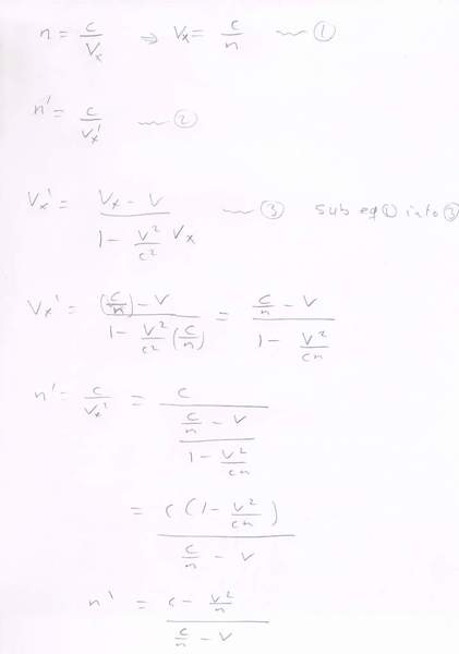

hello
i have this question
" a liquid has refractive index (n). find the refractive index of this liquid for an observer if the liquid have a velocity (v) to this observer "
i have my solution in an attachment
please look at it and tell me if it is the right solution
thank you very much

The approach is correct up to the point where you make a mistake in the calculation of [itex]v'_x[/itex]. The formula that you use is incorrect, look at the term [itex]1-\frac{v^2}{c^2} v_x[/itex], what you want is [itex]1-\frac{vv_x}{c^2} [/itex]
sorry but i don't get it.
can you explain it more. i thought my formula is correct
or is there something is forget?
what about the rest of the solution
please if you have time, can you give me the complete solution to this question
i have tomorrow an exam and i have no time
please do me this favor
thank you very much

No, it isn't.
Once you make this error, everything else becomes incorrect. You need to learn how to check your own work, especially after your errors are pointed out to you.

We do not do your homework for you, you don't learn anything if I do it for you. I gave you the exact error in your derivation, your speed composition formula is wrong and I pointed out your exact error.
To add to what xox has already said. Your end result cannot be correct on dimensional grounds. Dimensional analysis is always a good check to see if your result makes sense. In your case you are subtracting a velocity squared from a velocity in the numerator. Since velocity has dimension length/time, velocity^2 has dimension length^2/time^2 and you cannot add or subtract quantities of different dimensions.

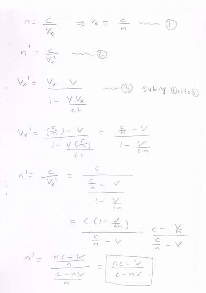

omg that is so embarrassing
sorry but I am out of time. that's is the reason for my stupid mistake
i get it and have again my solution in an attachment
yes you are soooo right.
thank you again

It is better but you still have algebraic errors. Check your work.
i checked it but didnt find any errors
Yes, it is right now.
Ok. Thank you for your help
