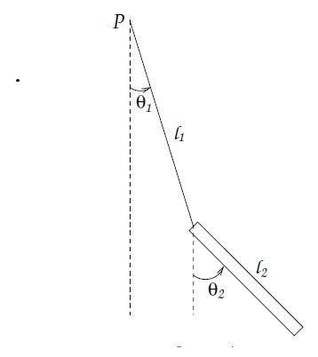

[itex]\frac{l_{2}}{l_{1}} = \frac{1}{4} [/itex]
[itex]\frac{g}{l_{1}} = 1 [/itex]
I need to find the normal modes of oscillation. (for small oscillations)
I solved the problem using the matricial way and got the following matrix: (I simplified it using the above ratios)[itex] V - wT = m \begin{pmatrix}
1 - w^2 & -1/4 \\
-1/4 & 1/8 - w^2/48
\end{pmatrix}
[/itex]Solving the determinant of the matrix I got two positive solutions. Now the thing is for each solution I got two different configurations of amplitudes. I thought that each normal frequency would give me only one configuration of amplitudes. Can you make this clear for me? Thanks.

Hi, sorry but what was the problem statement? where is the mass located? It is hard to follow along without knowing that...
