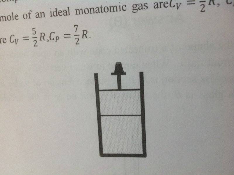

A container has movable(without friction) piston on top. The container and the piston are all made of perfectly insulating material allowing no heat transfer between outside and inside the container.
The container is divided into two compartments by a rigid partition made of a thermally conducting material that allows slow transfer of heat.
The lower compartment of the container is filled with 2 moles of an ideal monatomic gas at 700 K
And the upper compartment is filled with 2 moles of an ideal diatomic gas at 400 K.
The heat capacities per mole of an ideal monatomic gas are Cv = 3/2 R , Cp= 5/2 R and those for an ideal diatomic gas are Cv= 5/2 R, Cp= 7/2 R.
Q. Consider the partition to be rigidly fixed so that it does not move. When equilibrium is achieved, the final temperature of the gases will be

What does that mean? One says it will move, other says it won't.
I think there is a change in volume in the upper compartment.
See this diagram
Likes mooncrater
Hmm.. That could be possible.
Then what C we should take for upper compartment?
I don't think any C would work now..
I was thinking that :
Energy from the bottom part= work done to change volume of upper part+ energy to increase temperature of upper part.
To calculate the work done, we may take the final pressure of the upper part to be equal to atmospheric pressure. The problem here is that we don't know the initial pressure or initial volume. What do you think?

I saw the solution somewhere and they have taken cp for upper compartment and cv for lower compartment.
Don't know why?
That way the answer D will come.
I know there is constant volume in lower compartment but how constant pressure in upper one?
Likes mooncrater
A reason for constant pressure can be that since its given that the piston is free therefore initially the pressure inside the upper part would have been atmospheric pressure since it has to stay in equilibrium with the pressure outside. Moreover since the piston is always free therefore the upper part has to stay in equilibrium with the outer pressure always, thus always having a pressure equal to the atmospheric pressure. What do you think?
Likes Raghav Gupta
Thanks, got it.
