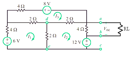

Find the Thevenin equivalent circuit at terminals (a,b) for the circuit below.
I am having a conceptual issue for this circuit. I can't combine any of the resistors, and my gut is telling me that something about the fact that its between terminals (a,b) means that one of these resistors can be neglected and essentially erased. However, I don't understand how that works as far as what signs I should look for and what should be neglected.
I removed all the sources in an attempt to find the thévenin equivalent resistance.

Nothing can be neglected (your gut is wrong) and since you (as you correctly stated) cannot combine, as serial or parallel, any of the resistors, how might you go about finding the equivalent circuit ?
If I can't combine them, then I don't know how to find an equivalent resistance.
Do you know how to do loop analysis ? Do you know Kirchhoff's laws?
Yes I do know them. I don't see how I can use that to find the equivalent resistance when I set all the sources to zero
Ah, well how about delta-Y transforms, do you know them?
An alternative is to create a Thevenin equivalent for a subset of the circuit and go from there. Do it more than once if that's what it takes.
I was told that the 2 ohm resistor that is vertical (between d and e) has no current going through it, thus can be essentially ''erased'' from the circuit. It gives the correct answer, but I can't figure out why it is the case

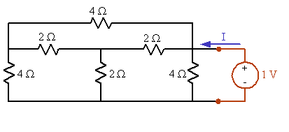

If you suppress all the sources in the given circuit then you're left with just a network of resistors. If you then apply a known voltage across the output terminals (a - b) and determine the current that source drives into the port, you can determine the net resistance.
If you intend to use loop analysis on the resulting circuit, I might recommend removing the 4 Ω resistor across the applied source first. It's a known resistance in parallel with the rest and can be "added" back later. The benefit of removing it is that it reduces the number of loops by one.
Another method for finding the Thevenin equivalent of a circuit is to tack a load resistor RL onto the output and solve for the voltage Vout across RL (leaving RL as a variable, of course).
Use any method you like (loop, mesh, nodal). Take the expression you get for Vout and hammer it into the form of a voltage divider expression, since for a voltage divider formed from a Thevenin equivalent circuit with a load attached,
$$V_{out} = V_{th} \frac{RL}{RL +R_{th}}$$
Then simply pick out the terms for Vth and Rth from the result. Easy.

What I did was solve for the currents. Using your labeling, I get
I1 = -1/10 A
I2 = -19/10 A
I3 = -3/2 A
Then I multiplied the 4 ohm resistor by I2 and got the Vab = -7.6 V, which is the correct answer for Vth. Now I am struggling to solve for Rth. I thought I could add a short circuit to the terminal (a,b), solve for the short circuit current, then divide Vth by Isc to get Rth

Yes, dividing Vth by the short circuit current will also give you Rth.

Okay, well I redid the circuit with a short circuit, and here are my new equations
-2 -2 8 0 = -8
8 -2 -2 0 = 6
-2 8 -2 0 = -12
0 -4 0 4 = 0
then I get i4 (Isc) is -1.9 A, and divide 7.6/1.9 and it gives me 4 ohms, not the correct answer

-2 8 -2 -4 = -12
0 -4 0 4 = 0
You forgot the item shown in red above.

Finding Thevenin equivalents consist of finding Vth, which is just finding the voltage across a couple of nodes, and finding Rth. Finding Rth can be done by finding the current in a short circuit across those same two nodes and dividing Vth/Isc. Or you can apply an external test current or voltage with the internal sources set to zero (except the dependent sources).
For instance, in post #9, gneill's first image shows the method of applying a test voltage. If you make the test voltage 1 volt, then your equations would become:
-2 -2 8 0 = 0
8 -2 -2 0 = 0
-2 8 -2 -4 = 0
0 -4 0 4 = 1
If you solve that system, the current in your added loop is the reciprocal of Rth; couldn't be easier.
