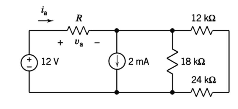

given the circuit shown below find the the vanin equivalent at resistance R.
the resistances on the right side of the circuit can be simplified: 18 || (24+12) = 12 kΩ.
The voltage can be found from 2 mA * 12 kΩ = 24 V.
The voltage Va = 12-24 = -12 V
When using multisim and the multimeter within the program it tells me the voltage of the open circuit is 36V.
Can anyone help me out?
With what polarity? Assume the bottom wire to be at 0V.

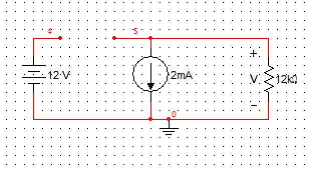

garr6120 said:
+ to - from left to right.
I was talking about the equivalent resistance of the three resistors in the rightmost loop, which is 12k ohm. Draw this simplified circuit and find the polarity of the resistor terminal connected to the 0V point.

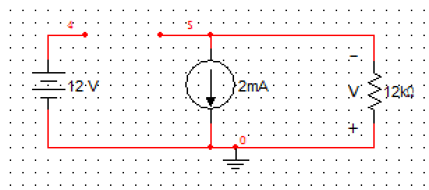

garr6120 said:
The current source is of 2mA, and you need to find the open circuit voltage. You have instead short-circuited the resistance R.
garr6120 said:
The polarity of the resistor voltage is wrong. Conventional current flows from higher potential to lower potential.

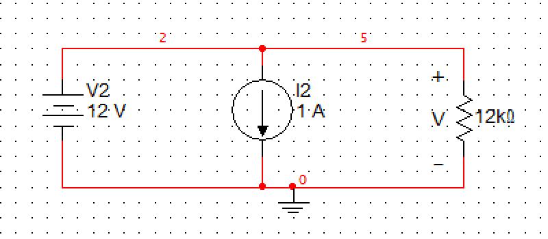

garr6120 said:
but here it is.
That is correct. So now you can see why the answer is 36V.
I thought the 12 V source wouldn't receive any current because of the open circuit.
Should I use KVL because when i make a loop at the open circuit i get:
-24V-2mA*12Ω=-12V
