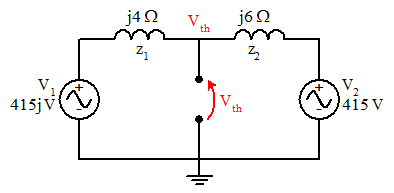

Thevenin equivalent voltage is
Vth = 6j * i + v2
Vth = 299.26∠56.31
What formula have you used to calculate this?
Are you asking how to go from this rectangular form: Vth = 6j * i + v2
to this polar form: Vth = 299.26∠56.31 ?
Or are you asking about the substituted values for i and v2?

No i can convert rectangular to polar, I'm looking to find out how you go about getting Vth when you've multiple sources of voltage.

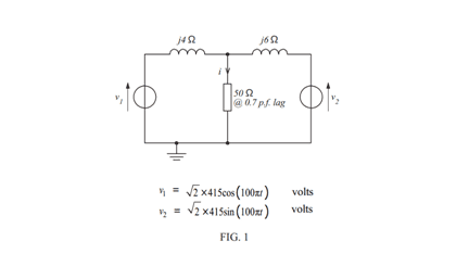

magician said:
FIGURE 1 shows a 50 Ω load being fed from two voltage sources via
their associated reactances. Determine the current i flowing in the load by:
(a) applying Thévenin’stheorem
(b) applying the superposition theorem
(c) by transforming the two voltage sources and their associated
reactances into current sources (and thus form a pair of Norton
generators)
[/B]
Would i be correct in saying that i = 5.71 + j0.892 A?
That's from Vth / (Rth + Rl) = 166 + j249 / (0 + j2.4 + 35 + j35.71).
  • #112
That's correct; now all you have left is part (b) and (c). :smile:

My apologies.
i did essentially a kvl walk clock wise around the circuit with the load removed, ( to calculate the circuit current) then transformed for the value of the current
V1 - j4*i - j6*i - V2 = 0
V1 - V2 = j4*i + j6*
j415 - 415 = i(j4 + j6)
(-415 + j415) / j10 = i
multiplying by conjugate - j10
(-415 + j415)(-j10) / (j10)(-j10) = j4150 - 4150j^2 / -100j^2
Since j^2 is = to -1
(j4150 + 4150) / 100 so current = 41.5 + j41.5
however i noticed that people have a negative value for the imaginary component of the complex number.
so I am not sure if i am going wrong with the calculation,or the initial circuit equation i made up.
  • #137
The Electrician said:
Have a look at post #104 and 105.
i made a typo. the complex value for the current i have is (415 + j415).. which is somewhat different to others values people have got.
i have also just put the values of the equation into the wolfram calculator and have the same values that i have just shown. i think i possibly did something wrong with my circuit equation.
  • #138
See post #66.
You can choose either V1 or V2 for the phase reference. Either will work, but it will change results.
  • #139
See post #66.
sorry I am not sure i follow. is there a reason i should pick V1 over V2 as the phase reference.
  • #140
There's no particular reason. V1 is a cosine wave and V2 is a sine wave. Either will do as the reference. Some people might like sine waves rather than cosine waves, or vice versa. But, the phase you get for the various currents and voltages will depend on your reference. The sign of real and imaginary parts will be different depending on which reference you choose.
If you use the sine waveform as a reference, then V1 = 415 j volts and V2 = 415 volts. If the cosine waveform is your reference then V1 = 415 volts and V2 = -415 j volts. Either will work; this is what's mentioned in post #66 and 67.
28
