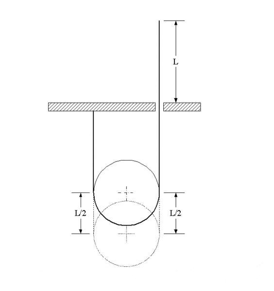

I'm currently working on this problem too and have run into the same problem but I can't understand why if the vertical displacement of M3 is twice the horizontal displacement of M1 and M2
If one side of the string is attached to a ceiling and we just move M1 (so I think the same as what the second post said) wouldn't moving M1 some distance equal the distance M3 is lowered?
Consider a pulley and rope with one end of the rope secured to the ceiling and the other end is lowered by a distance L. This amount of rope, L, must equal the total of the amount of rope gained on each side of the pulley as it falls. Thus L = L/2 + L/2, and the pulley moves down by half the amount that the rope end was moved. Note that this also accounts for the mechanical advantage inherent in this setup -- the load (pulley) moves half the distance that the input moves.
Thanks gneill! Makes sense now!
