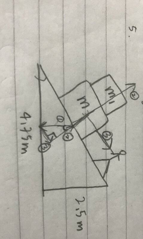

attached below
N= mg

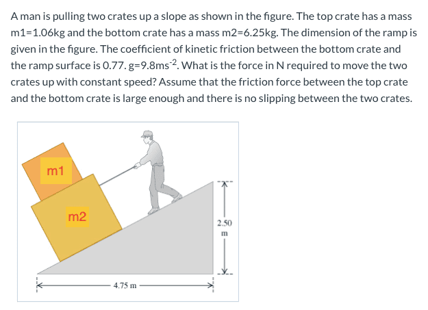

first, i calculated the kinetic friction:
0.77 x (weight of the 2 boxes x 9.8)= 55.16N
then i calculated the angle of the triangle:
tan^-1(2.5/4.75)=27.758
then i drew this
then i used sine to find out force 3 which is 33.3556
so the final force needed is 33.3556 + kinetic friction= 88.516
is this correct?
My numbers disagree with yours. Since you do not provide the equations in which you substituted the numbers, I cannot check the details of where you went wrong. The statement
is not informative enough. Please post a more complete solution.
