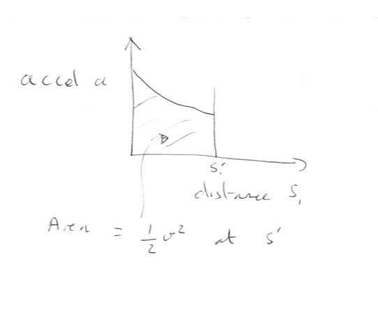

I have already suggested drawing a graph, if you want to avoid integration.
Note I made a slight correction to my earlier post in the velocity term.
The area under an acceleration - distance graph equals yields the velocity.
You can draw this since you have been given the acceleration as a function of distance in post#3
The proof uses integration, but you do not need to do so
[tex]\int {ads = \int {v\frac{{dv}}{{ds}}} } ds = \int {vdv = \frac{1}{2}} {v^2}[/tex]
So the area under the accel-dist graph from zero to any distance s' gives [tex]\frac{1}{2}{v^2}[/tex] where v is the velocity at s'.

Averaging will not work as it did to obtain the constant acceleration formulae.
This was answered in post#4

the electron is at rest, at 10^ 9 cm up high), after 1 second it as a speed of 65 cm/ s.
acc = 65
after 2 second speed = 92 cm/ s
acc = 27
in this case KE, speed increases slowly with time not ACCELERATION
(never mind if the figures are not exact , what count is principles, procedure)
Hope I made myself clear.
as to integration, you did it.I haven't a clue
