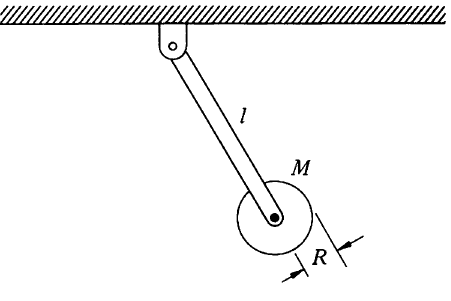

Find the period of a pendulum consisting of a disk on mass M and radius R fixed to the end of a rod of length l and mass m. How does the period change if the disk is mounted to the rod by a frictionless bearing so that it is perfectly free to spin?

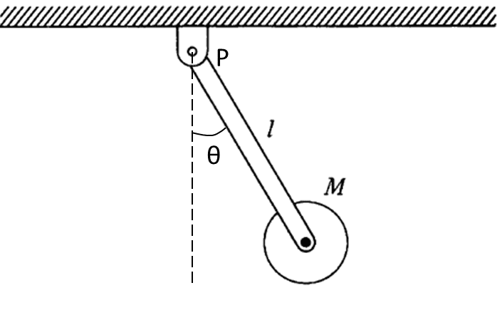

If the rod is displaced by an angle ##\theta## as shown in the attachment 2, the torque acting about the fixed point P is
$$\tau=-\frac{mgl}{2}\sin\theta-Mgl\sin\theta$$
From small angle approximation, ##\sin\theta \approx \theta##. The moment of Inertia about P is
$$I=\frac{ml^2}{3}+M\left(\frac{R^2}{2}+l^2\right)$$
Let ##\alpha## be the angular acceleration, then
$$\alpha=-\frac{gl\theta}{I}\left(\frac{m}{2}+M\right)$$
Is this correct?

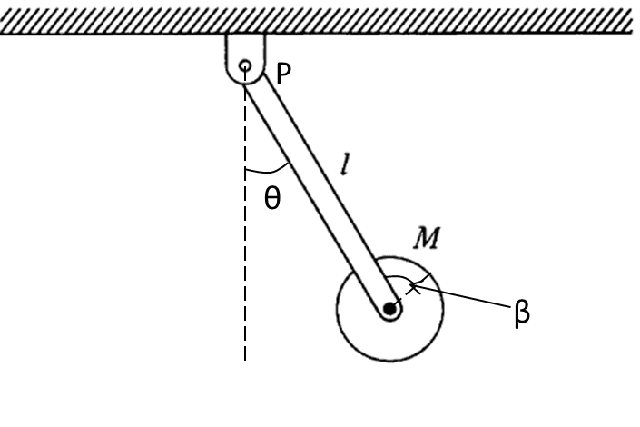

Moving to the second part of the question, I am thinking of assigning two angular velocities to the disk, ##\omega_1=\dot{\theta}## about P and ##\omega_2=\dot{\beta}## about CM of disk. Next I will write the expression for energy at any instant and differentiate it wrt time to find the time period. See attachment 3.
I came up with this: ##R\beta=l\theta##. Is this correct? Is my approach correct?
Any help is appreciated. Thanks!

Remember that if you let the disk spin without friction at the axle, there are no torques that will affect that angular velocity.
Thus, you can regard w_2 as a constant.
So that means the time period won't change? Is my attempt at the first part correct?
I think my answer to the first part is correct. I checked it by letting m=0 and ##R\rightarrow 0##. This gives the time period of simple pendulum.
Yes, I believe the first part is correct (don't remember the appropriate moments of inertia right now, but that's the only place it might be wrong.

I am not so sure, Pranav...
Here's what I think (I did this question a few days ago):
When you let the disc freely rotate it will no longer be a rigid body- the equation in #1 was for a rigid body( ie. ##I=\frac{ml^2}{3}+M\left(\frac{R^2}{2}+l^2\right)##)
And moment of inertia won't be the same.
As,
##I_2=I_{rod\ about\ pivot}+I_{disc\ about\ pivot}##
##I_2=\frac{ml^2}{3}+Ml^2 ##(##M\frac{R^2}{2} ##won't contribute as its free to rotate about that axis)
And hence it should have a change in time period (according to me).

I don't get this. Why it doesn't contribute to the moment of inertia? "(##M\frac{R^2}{2} ##won't contribute as its free to rotate about that axis)", can you please elaborate this? :confused:
Thanks!
Pranav-Arora:
When the disk is FIXED, each material particle of the disk must share the angular velocity w_1, since they are part of the rigid body.
When the disk is NOT fixed, those material particles have angular velocity about its axis w_2, but that is a constant.
Thus, the rate of change of the ANGULAR MOMENTUM is different in the two cases
There is no torque that would make the disk itself rotate with respect to the rest frame of reference. So the change of angular momentum comes from the rod with the disk as a point mass at its end.
ehild
They have w_1 about the fixed point P too, no? I don't really see what I am missing here, I just can't understand the situation.
Enigman says that it will no longer be a rigid body. Why? Does it change the shape or is there something more to the definition of rigid body? :confused:
It is in the second instance, as ehild writes, ONLY as a point mass the disk contributes, not in addition to that as a disk.
1. "They have w_1 about the fixed point P too, no?"
THAT contribution will only be through being a concentrated point mass at L.
If you look at the point along the rod vector at distance L+R from P, then in your FIRST instance, the whole length L+R rotates with w_1, but in the second instance, the part to L (i.e, centre of mass of disk) rotates with w_1, but from L+R, w_2 is the local angular velocity followed.
2. "no longer be a rigid body. Why?"
Material points on the disk change, for example, their position relative to a fixed point on the rod. That is NOT true when the disk is firmly attached to it.
Remember:
For a RIGID body, ALL distances between material points on the body must remain constant throughout time. This is NOT the case when the disk allowed to rotate.
If the disk is not fixed to the rod, then it will not rotate as the pendulum oscillates.Hence it does not contribute to the moment of inertia of the system. Please note that now the pendulum is no longer a rigid body as was the case when the disk was fixed.
So ,Moment of Inertia about pivot point =M I of the rod + M I of the disk treated like a point object.
