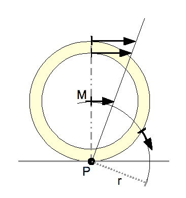

you might want to clear that out, instantaneous center of rotation is different from center of rotation (usually taken to be COM for rolling ball).
P is the instantaneous center of rotation whereas M is COM.
Saitama
4,244
93
<image>
I do know what is an instantaneous centre of rotation. Is there some error in my equations?
NihalSh
199
I believe you have taken the distance (moment arm) ##\frac{R}{4}## incorrectly.
Edit: I believe moment arm should be ##\frac{3R}{4}## if the distance (force is applied below COM) from COM is ##\frac{R}{4}##

NihalSh
199
Angular acceleration is related to acceleration of CM of ball by ##\alpha=a/R##. I guess friction is known here, right?
That relation is only valid for pure rolling (no sliding). You shouldn't calculate torque about ICR, if the body is accelerating (remember what I said previously about fictitious torque).
friction in this case(back spin case) would be kinetic. and after a while if friction is present then, rotation rate would decrease (and change direction, if situation permits) and because friction acts in the rear direction, velocity of COM would decrease. So given sufficient time the ball would eventually start to pure roll.
Again depends on situation, if force is steadily increased then you must know friction to tell when the object will start to backspin. On the other hand if impulse of high magnitude acts, then you can ignore friction (assuming impulse acts for such a short time that friction doesn't get a chance to set in). And you can use linear and angular momentum conservation to determine the rate of rotation, just after impact.
Saitama
4,244
93
...because friction acts in the forward direction,
I don't agree with this. In the backspin case, the particle in contact with the ground has forward velocity so the friction acts backwards.
But then, it means I can't use the instantaneous centre of rotation. :confused:
NihalSh
199
yeah, my mistake for overlooking that!...edited the original post...thanks for pointing that out!...btw I meant backward but wrote forward the rest of it was correct...silly me!:redface:
But you get the point, the ball will eventually start to roll. If translation kinetic energy is high enough it would continue in the forward direction. otherwise it will change direction and start moving in the backward direction, and at some point it will start rolling. But if translation and rotation kinetic energy both become zero simultaneously then the ball will stop moving.
NihalSh
199
Use COM as it can always be used.

But I am still stuck at the following point:
and (same case), if P is an "initial" position of the c.o.r, then rc.o.r is always parallel to mvc.o.m, so that's d/dt((rc.o.m - rc.o.r) x mvc.o.m) = mr2α, which we can add to Ic.o.mω to get Ic.o.rω
How do you get "d/dt((rc.o.m - rc.o.r) x mvc.o.m) = mr2α"? I have attached an image describing the situation. I hope it will help you to explain things easily.
rc.o.m - rc.o.r is a constant, the vertical vector of length r
so you have d/dt(mrv) = mrdv/dt = mra = mr2α :smile:
