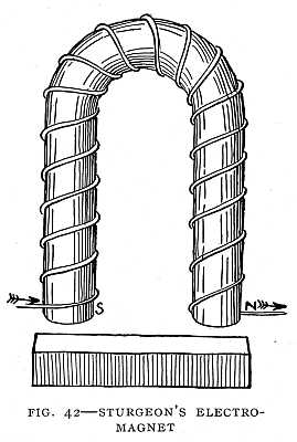

@shishir.gupta -- are you meaning to make a type of horseshoe electromagnet like this?
http://www.scientificlib.com/en/Technology/Literature/ElmerEllsworthBurns/images/fig-42.jpg
That's one working configuration, but the electromagnets used in scrapyards use a better design that you can look up. It's a circular center pole surrounded by a circular outer pole. These can use solid steel because it uses DC current and eddy currents are transient at magnet turn on and turn off only . However, if you can get by with a C shape, in core catalogs those are called "cut cores" or "C cores" and are often available off the shelf. You can use two C cores paired into an E shape to approximate the coaxial design used in scrapyards, and the laminated design will allow drive with full wave rectified AC sans other filtering. Just make sure the current is appropriately limited.
Likes shishir.gupta

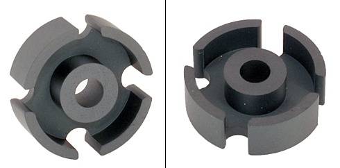

To concentrate the field ( flux per m2 ) you could use a ω-shape ( the field somewhat concentrated above the ω ) instead of an E-shape.
The magnetic field tends to find the shortest way around, so the legs of the core must be kept spread until the field is of use ( in the airgap between magnet and iron-body ). That's the idea.
Another suggestion ( circular E-core ):
That could be done... Thanks !
